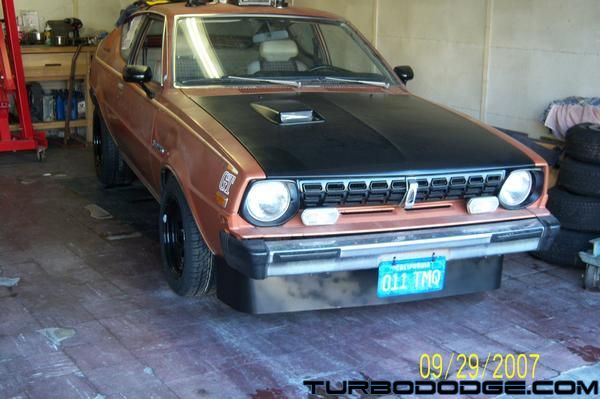

    I'm running a 89 2.8 with a t5 in a 1977 plymouth arrow/ Mitus Celeste

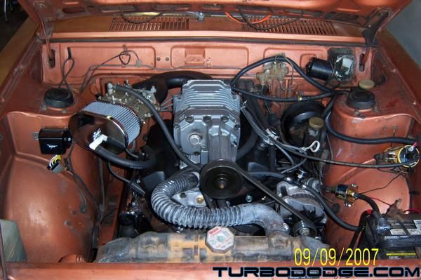

    N/A the car run and feel nice, but I got a wild hair one day and built a
    blower set up for it! Using a Eaton M90 6-8lbs boost+/- First I due to limited room I ran a Side Draft Weber carb didn't work out to well, hard to tune. Now I'm running a Holley 500 2 barrel and It's runs like a bat out of hell, But I'm still looking for something better.
    I would like to run a stand alone EFI or even a TBI that will support it
    I'm coming to all of you for help.... What should I do? who should I use?

    I guess the first question to ask is, what is your budget? Next question to ask is, how are your wiring and soldering skills? I would say a good candidate for what you are wanting would be a Megasquirt. Do some searching on the site (the standalone computer section of the forum would be a good place to start) and see what you think. Then come back and we can start up a more detailed discussion.

      What kind of intake manifold is that blower sitting on? Can it accept injectors in the runners? If so this swap wont be so hard you would just need to get the injectors in there and then find a way to put a throttle body on the blower. That would be the majority of the hardware. The wiring and ECM would be the next step after that.

        The manifold lower half is a fiero bottom and the blowers sitting on a
        plenum I built, as for setting up injectors and building a intake for the throttle body is not the problem.. That's the easy part
        What I'm worried about is a harness and brain..

          Well in that case you have tons of choices. You can go with a modified factory OBDII system, a Megasquirt system or a fancy aftermarket system like FAST or Holley.

              MegaSquirt sounds like the way to go on this. Cheap and works with boost well. Get the knock sensor kit while you're at it so you can make sure it won't blow up. Fuel injected and tuned well you will make a ton more power than you are now, and better power band.
              Then in the future you could go to a camaro 3.4 RWD iron block, with 3500 LX9 or 3400 LA1 top end on it for even MORE power. Oh and a cam too. It's RWD so you'll have the traction for the extra power!

                    Well looks like I have picked a unit. I'm going to use a 2nd gen RetroTek
                    self teching tbi set up. Closed loop, self mapping, can handle up 30lbs boost,
                    I've givin a deposit and awating a harness from them to complete the build...

                      I'd give the OBDI GM ECM a look.
                      I have one running an L28 (inline 6) in my 1973 Datsun 240Z. I have yet to find another ECM that has the capabilities that the P4 OBDI GM ECM has.
                      I'm running a '7749, with Code59, 3 BAR MAP, WBO2 fueling control, Boost control scaled to speed. and many other features, some planned some in alpha testing, currently I'm playing with a knock gauge output, so what ever the ECM is reading the gauge or row of LEDs (which ever type of display is connected) will show the amount of knock retard. Meth/nitrous control is also planned.
                      Tuning is not difficult, software is free or very small donation to get rid of the nag window when using Tuner Pro RT (www.tunerpro.net). There are also products that will allow real time tuning while the car is being driven. These products are supplied by moates.net, there are others but seem to be less refined than moates.net products.
                      The actual ECMs themselves can be found cheap at wreckers, and can be had in under dash units or under hood units.
                      The OBD1 GM ECM also has On Board Diagnostics, limp home mode, and a lot of support through many online communities.
