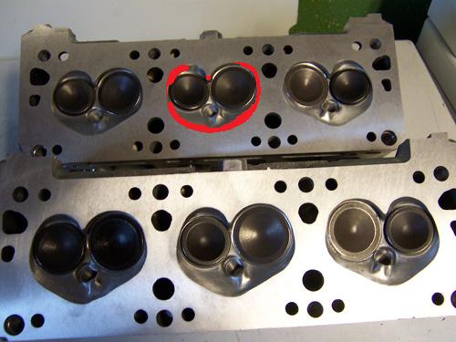

        Vortec top right, non vortec top left, 3400 bottom. Vortec is not splayed valve, meaning the valve just go parallel to the bore. 3400 move the valve further from the chamber edge and cylinder walls as it opens.

          thank you so much for this!! i do realize that the orientation of the valves would need to remain the same-but what im curious about is could i have him just reshape the combustion chamber a bit as shown (yes, its a rough i made with windows paint :P)? looking at it i dont see anywhere that would need added-just removed & reshaped. please let me know what you think & if its a dumb idea can you please continue to show me as to why like you have been?

            Vortec is just a name. The chamber design is the same for all the fast burn heads which is all a Vortec head is. The large quench area is what causes the swirl in the head. When the piston arrives at TDC the gases in the quench area get squished out into the heart shaped area around the valves and spark plug, causing the gases to swirl and mix better. So save your money.

                          I don't think you got the point of my post. A Gen III head is a "Vortec" head, hell even a Gen II head is. The Gen III heads are as good as it gets and even BETTER than a "Vortec" 4.3L head since it has splayed valves and is made of aluminum. The heart shaped chamber with a large quench is what makes the power.
                          Like I said "Vortec" is just a name. For example the LS1 or LS6 in the Vette was called just that. But the 5.3L and 6.0L in the truck with the same head was called a "Vortec" motor. Even though the "Vortec" name started with Gen I small blocks, skipped right over the Gen II small block since it was never used in a truck and now the name is applied to the Gen III and IV small blocks, which in current trucks is a direct copy of their LS counterparts. So get over the name and stick with a stock head. Don't mill out the combustion chamber because you will lower compression and most likely hit a water jacket and then your screwed because scrap prices are so low you wont get dick for them.
