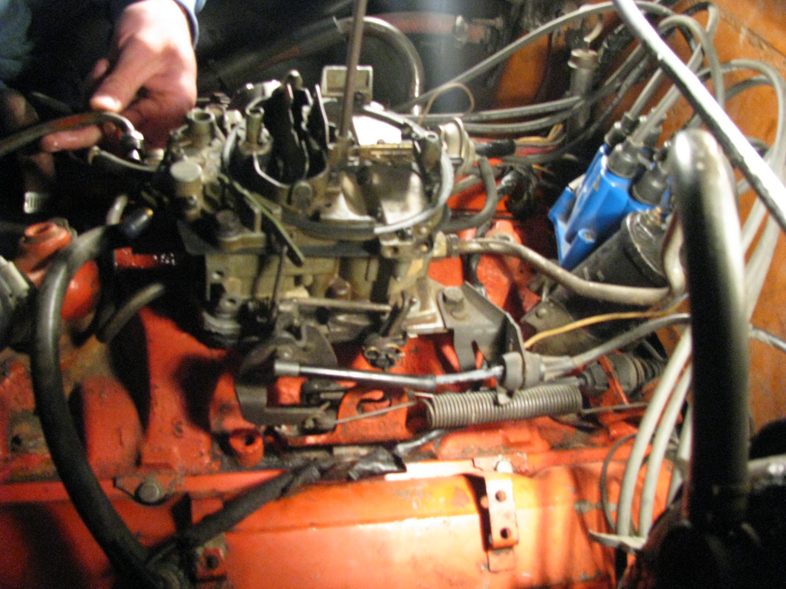

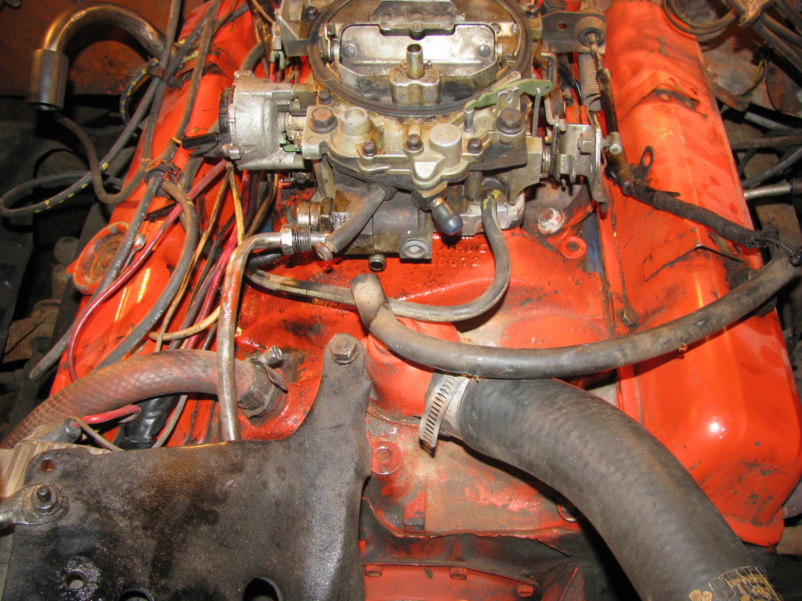

    I need to redo my intake again. It's leaking and puffing a little. I've been pricing out some aluminum intakes but I'm not sure what intake to get. I'd also like to replace the carb. Back story, the carb was rebuilt but they left some dowel pins in (or at least that's what they looked like.) I removed the carb and had those pins removed and put the carb on and they adjusted it. Problem is, it's missing like crazy and the back barrels don't open. I'm not sure if the missing is the intake leaking or not. I dont' think it is.
    My plan so far is to get a >74 distributor, replace the intake with an aluminum intake (the current one weights at least 50lbs.) Replace the carb and probably get some stock exhaust manifolds. Although the price of headers is chump change for a 350.
    I know the truck was pushing at least 300HP. It's a snappy old lady but it's missing so bad I don't want to drive it. I figure go ape on it and hopefully get it running good. I'm hoping to get some links for a intake/carb match that'll drop in. I'm not sure if rebuilding the quadrajet will fix it or not. Frankly I've dropped too much into it as is, so I figure replace it with something new and be done with it. That's assuming a intake/carb combo is cheaper than rebuilding it. Then again the last time it was rebuilt it was done wrong... Damned if you do, damned it you don't. I'm just tired of having shops do work and it's done wrong. Do it myself and if it's wrong, it's my fault.

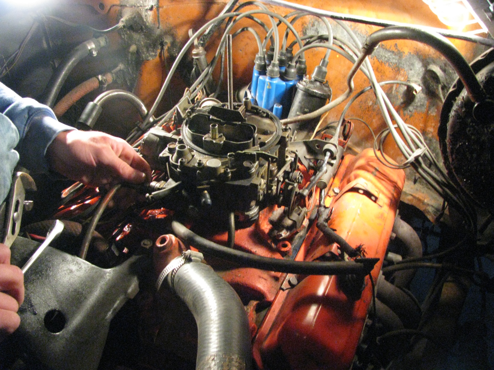

                        Last night I ran and did some quick errands. At a light, it started sputtering real bad. It almost looked tinted blue between the smoke and the sputter. I was maybe 2 miles from my house so it was a quick return trip. Half way there the exhaust leak clacking went away and was muffled. When I got out of the truck it smelt like gas, heavily. The oil also smell like gas. It's also really dirty considering I changed the oil 120 miles ago.
                        Just looking for suggestions before I tear into it.
                        • 86FieroSEv6
                          • Feb 2010
                          • 527
                          Hmmmmmmmmm, are you still using the stock mechanical fuel pump? If so, I would pull it and make sure it's not leaking into the crankcase. Other than that, your carburetor may be flooding, either due to a faulty needle and seat, float or choke not opening.
