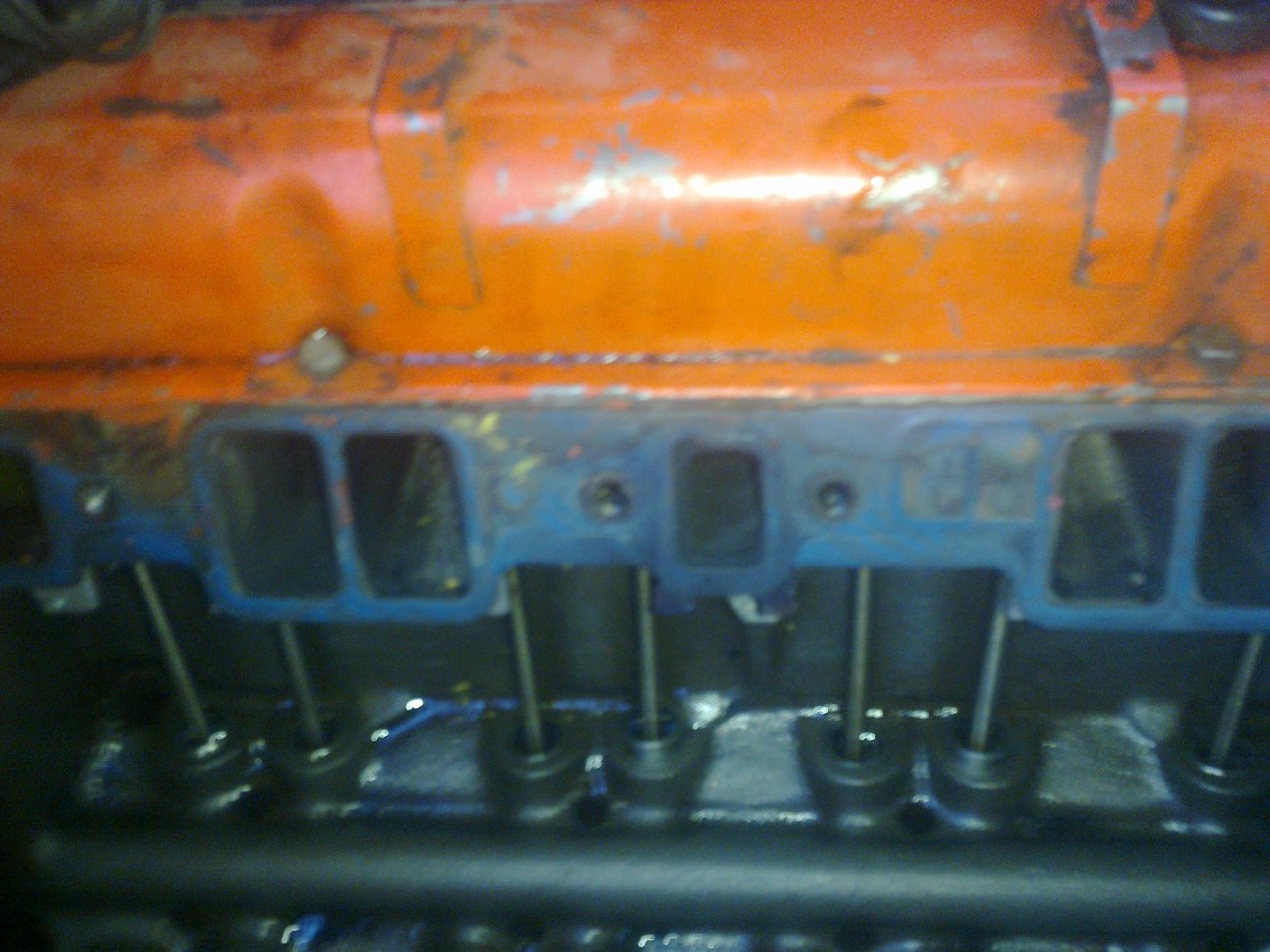

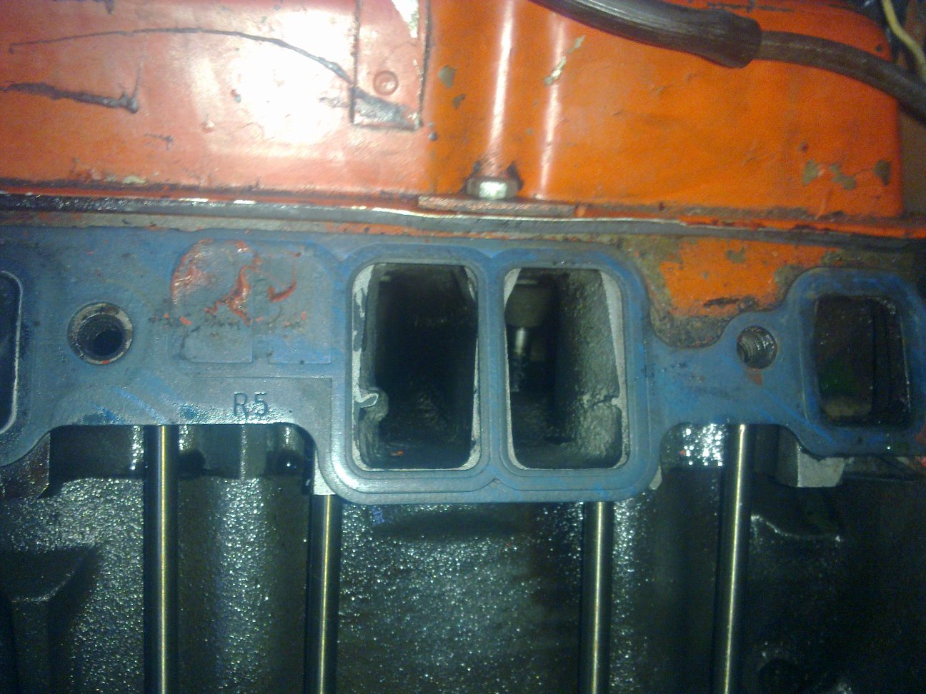

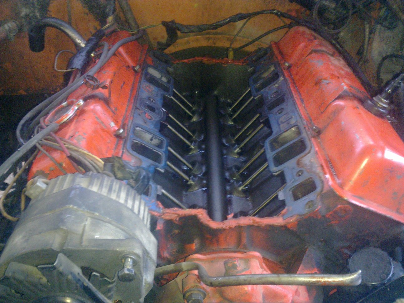

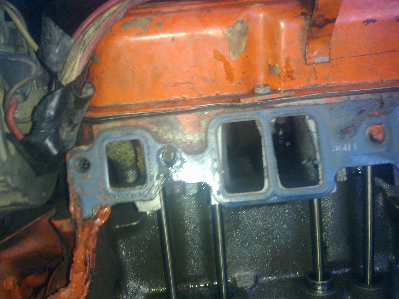

                              Changed the pump. Started it up, seems good. Pulled the intake. A couple intake ports are pretty dirty. I dont' think it was like that the last time I pulled it.
                              That's my achievment for the day. I walked 2 miles to the parts store, picked up a new fuel pump, intake bolts, oil filter and locktite. I figured put in fresh oil and run it for a bit before doing the intake. I'll change it again because a little coolant spit from the intake. Re-time it and do a valve adjustment and hopefully old trusty will fly again.
                              EDIT: I have to get a new fuel line tomorrow because I broke it on accident.
