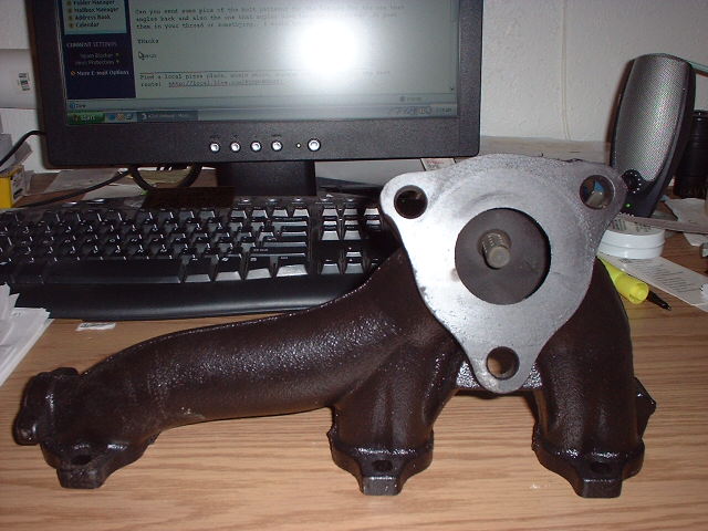

                    • Joseph Upson
                      Forget the logs, get a pair of the new design cast iron manifolds with the 3500 heads, they have a very nice contour and blend down to the collector end as well as nice open ports internally. On a turbocharged engine given that scavenging between the turbo and cylinder head is not going to happen much if at all under boosted conditions the gain a set of headers will have over these manifolds on the same engine might not be significant at all. Look at them compared to that Fiero log style manifold which believe it or not the Fiero guys have documented flow well enough to not warrant the header install some have been doing for the Fiero V6.
                      Another very, very important advantage cast iron manifolds will give you over all except an exceptional and expensive set of headers is durability under the heat stress and that is very important and at least for me desired over say a 15hp gain I might get from headers. I've burned through a tube before, no fun having to rework turbo plumbing for that reason.
