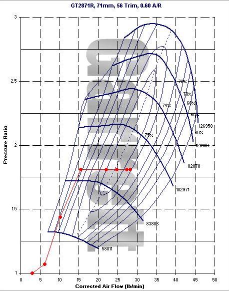

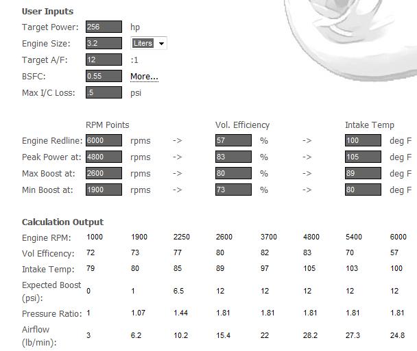

                          FWIW, here's the inputs I'm working with using the Squirrel Performance Calculator:

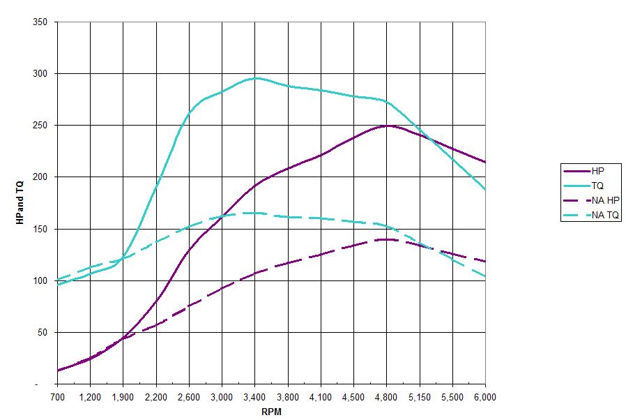

                          VE numbers are a guess, but based on a N/A BSFC of .49, these numbers calculated out to 140 HP @4800 and 166 lb-ft or torque @ 3400. Close enough to the figures GM rated the engine at to keep working with. For purposes of turbo calcs, I went conservative with the BSFC and upped it to .55 which, I suppose, is the same as saying efficiency decreases by 12% by going turbo.

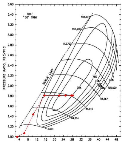

                          Here's a selection of compressor maps charted out based on these inputs:
ID:	373637Click image for larger version
ID:	373638Click image for larger version
Name:	T04E - 50 trim.jpg
                          It looks like any of the three produce acceptable results, with the 50 trim T04E as the most efficient of the three, all appear capable of producing maximum boost @2600 without surging. The question is which turbine configuration will spin that compressor up without creating excessive back pressure at higher rpm.
                          All things considered, I'll probably go with the T04E. Found a source with a water cooled center section, ball bearings and 65mm 70 trim .63 A/R turbine.
