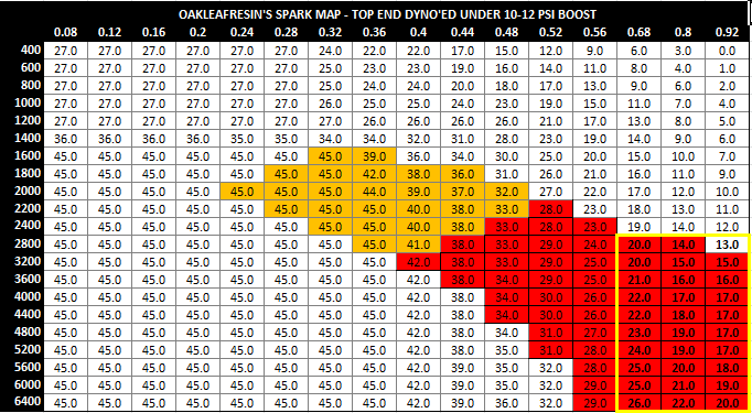

                    I agree w/ the sliding AFR. I slide two ways, the AFR gets richer over time & slides 0.2 AFR leaner at higher RPM's (leaner burns faster)
                    Here is a Spark Map I got from a poster at HPTuners/forum. His spark setting is pretty extreme and I won't use it BUT, the last three rows were dyno proven spark degrees at about 10 psi boost on a 3400v6. I've incorporated those figures into my spark map before and it worked great for boost. Anymore and I got knock.

                    • AleroB888
                      • Nov 2009
                      • 249
                      [ATTACH]6134[/ATTACH]
                      Interesting, that's for a turbo, right? I'll study that one a bit, might try the last row and smooth it into the rest of the table.

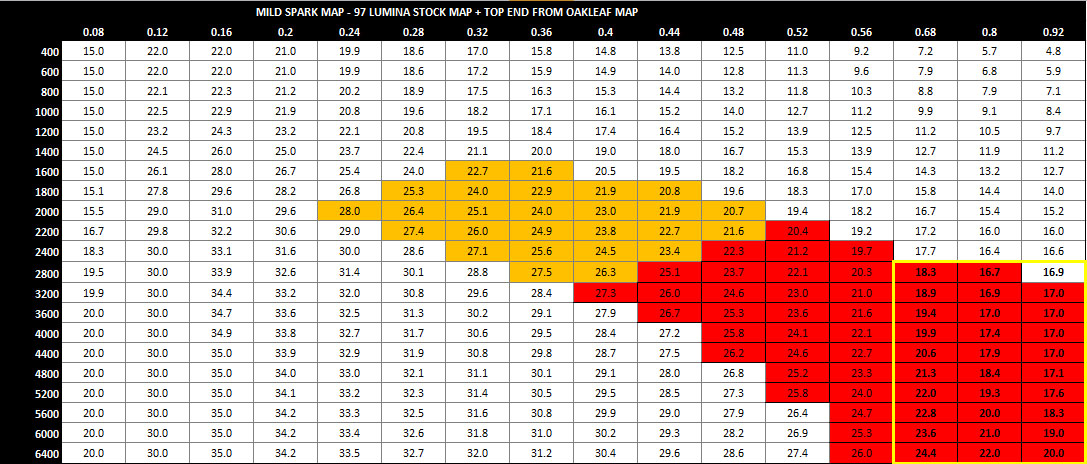

                        Here is a spark map I used in the beginning of my tuning. It is pretty passive except for the top end, which is worked into the Lumina spark map.
                        Can't upload excel doc's for some reason. 60degreev6 webpage won't allow the file type. SO heres a pic of it.

                        • AleroB888
                          • Nov 2009
                          • 249
                          [ATTACH=CONFIG]6138[/ATTACH]
                          That's within a degree or so of the map I am now using, in the lower right corner. I believe Ben had mentioned some time ago that if you go past 20* in the 3400, it won't make more power, so not to go past that even if no knock occurs. Can anyone verify that?
                          Also, is the only reason for running richer for the safety of the engine -- that is, to avoid knock?
                          I am wanting to try it at 12.5 to 12.8 AFR, because the duty cycle of my 36 lb. injectors is lower ( and more comfortable) there, and less fuel would be consumed. That is a concern because I suspect the fuel pump canister may be running dry before the end of my 1/4 mile runs.
                          And of course, if it makes more power at the higher AFR, I'd take that..............
