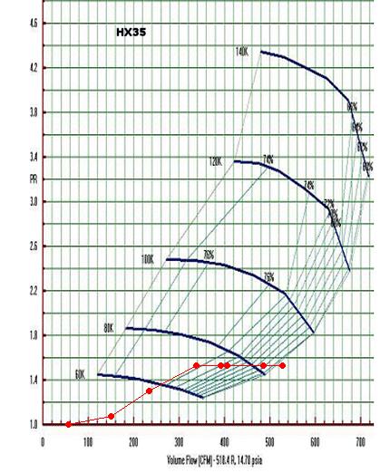

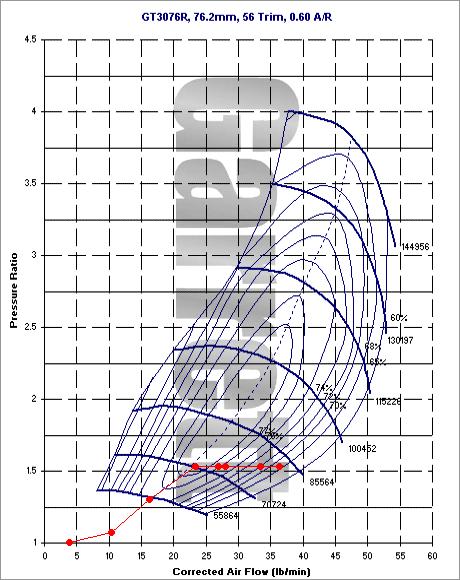

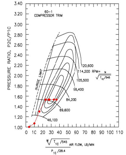

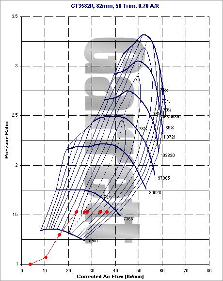

            ill post the maps, you tell me what one is the best. maybe Im reading them wrong? Im just going off the maps, thats how I came across the 60-1, it seems like it was the best match! I like to see stuff before I buy it, precision doesnt have maps!!! to me thats guessing. thats all im saying. maps for similar turbos are different. I just cant varify what you tell me due to the map issue.
            to my knowledge, you want to be in the center circle. more boost the higher you are on the map. I honestly dont know how much it really matters with how low of boost I plan to run but im the guy that cc matched and polished combustion chambers because its better. real gains? probably not. its just how I am, I try to be as technically prefect as I can. I have spend everyday this week online researching and learning for about 6 hours a day

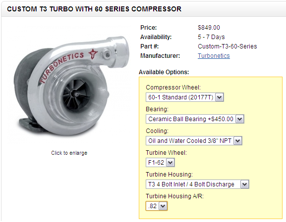

                        the turbo im REALLY considering.
                        not 100% sure if I want the .82 or .85 hot side. going ball bearing due to quality. it will spool faster tho.. is there another way to make it take longer to spool other than swap out housings? seems like electronics boost controllers can help with spool if I remember right.

                          The proof that the new billet wheels are better is the hp, and the qtr mile times that the cars run on them after switching. Be it Precision, or a Holset or Garret or whoever. They are more aerodynamic, weigh less, and stronger materials. They have the ability to run insane boost levels, not that you ever will, because the overall wheel design is better. You will not find any comp maps for the precision billet wheels because it costs too much money to have them done.
                          Also noone knows if you are plotting the maps wrong, because you have failed to show your math in what you are using to calculate your plots.
                          And I am going to correct myself. The 60-1 is a 59mm compressor wheel.
                          a .82 or a .85 isn't going to make any difference in spool. It will be unnoticeable so you can go with either one.

                            Big Cheese is right about the math. Be sure those figures are spot on. It's okay to ask questions about input variables. Better ask now instead of asking why it doesn't work the way the map said it would after you buy it.
                            As a good reference, I use a T04E-50 on my 3100v6. And I love it, spools up nicely while still allowing a low throttle range out of boost for city driving.
                            Now, your block is larger so it is too small for your engine, though just barely too small. So if you map out a T04E-50 and it is just barely too small, then your numbers are not too far off.
