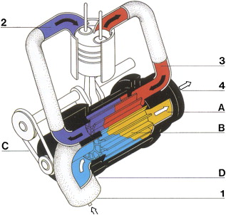

                            Pressure Wave Supercharger? They don't spin as fast as a turbo/SC and provides boost off the start. Interesting little device it is, I try to find more information about it but it is an uncommon way to boost up. It seems some exhaust recirculation would be a minor issue (tune around it) and higher temps IAT's. But the boost response is much better then a standard turbo as far as Ferrari tested in the 80's.
