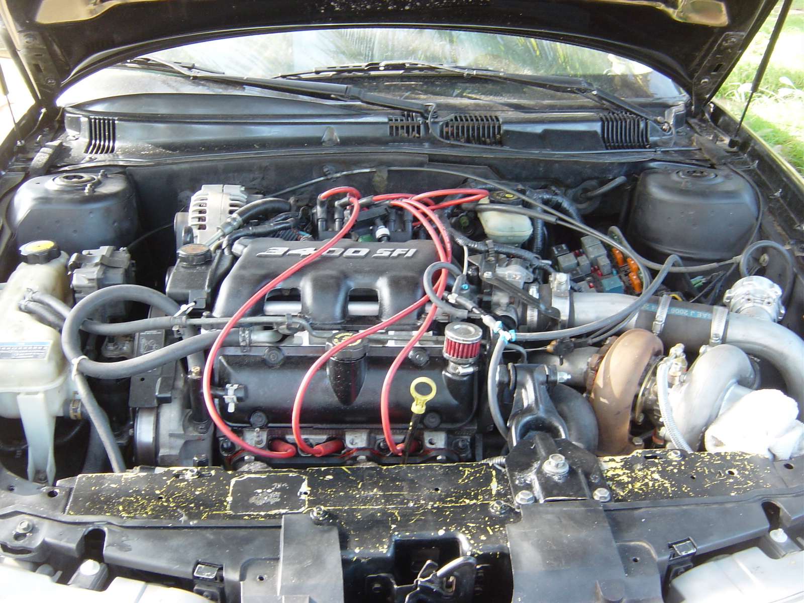

                          #27
                          Update
                          The axels are in, had to use the cup from the beretta's axel(the one that enters the gear box)(Driverside) because the stock alero axel uses a bigger oil seal then the one from the Hm-282. And that's about it. Pretty easy.
                          The bad thing is that I still didn't start the engine because had some problem with the front headers. bud every thing is bolted back in the car. Tomorow I will hopefully get the headers back and then start it.

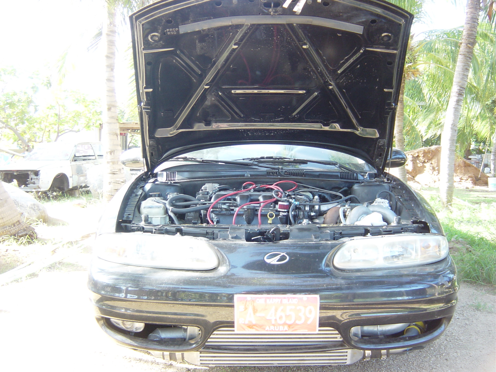

                              #29
                              Sorry for the delay, but the thing is that I'm still a student so school has begone. I have started the car, it runs good but still need the tunning because I thing buy removing the tranny it's idling a little ruff. but It's running lol. It's reving good just the idling is a small prob, but with the tunner I will be correcting that. it's still not finish but when I get the chance I will finish it.
                              I need a body kit really ASAp lol, the intercooler is to big for the front bumber lol

                                #30
                                good job homie, I am interested in why you replaced your pcv valve with a breather tho
