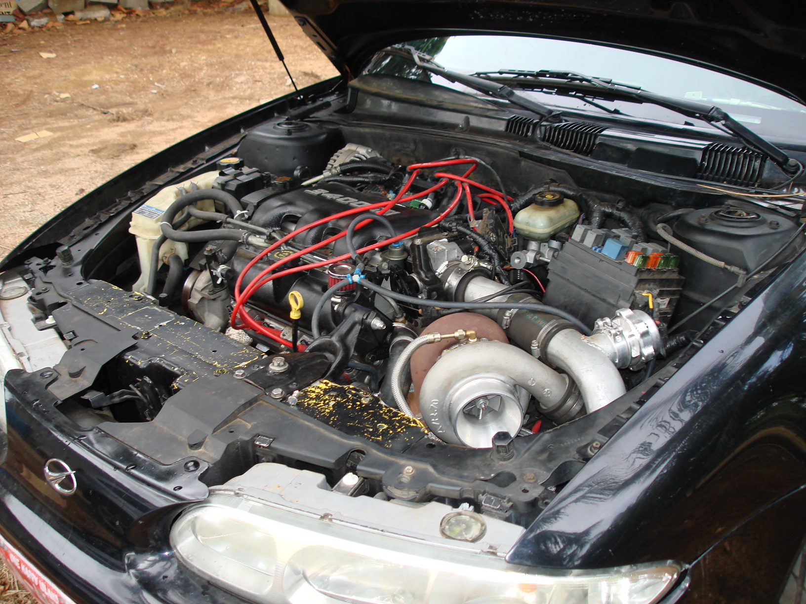

            T70, 46mm WG, 50mm BOV, 42.5# inj, liquid/air IC, P&P heads/UIM/LIM, 5.7L MAF, and coming soon, 4.3 Vortec TB (having a custom UIM made for that)
            last weekend:
            earlier shot of installing I/C setup several months back:

              Where did you get the rad. for the intercooler??
              Mega Squirted Fiero
              How I did it here

                  you are using a radiator for an intercooler? what size diameter pipe is that going in and out of your "intercooler". Or should I say rubber tubing
                  • TurboAlero
                    TurboAlero
                    • Jun 2006
                    • 136
                    #39
                    He is using air to water system.
                    • Guest
                      #40
                      Oh ok I see it now. Its down in front of the drivers wheel. I was going to say WTF. Looks cool. Definately a lot of cooling going on with that big ass thing there.
                      With a good tune tht thing should roll out pretty good

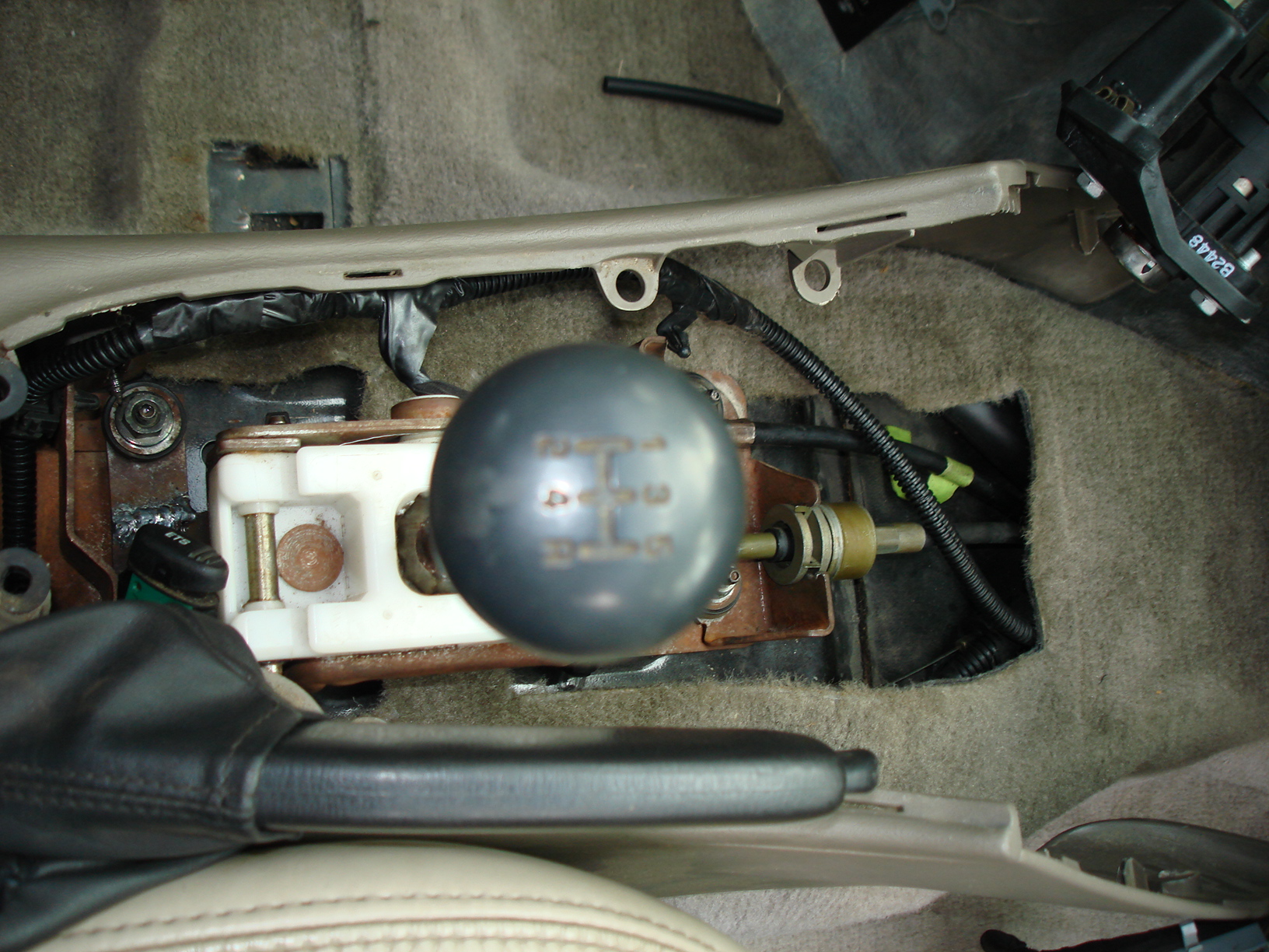

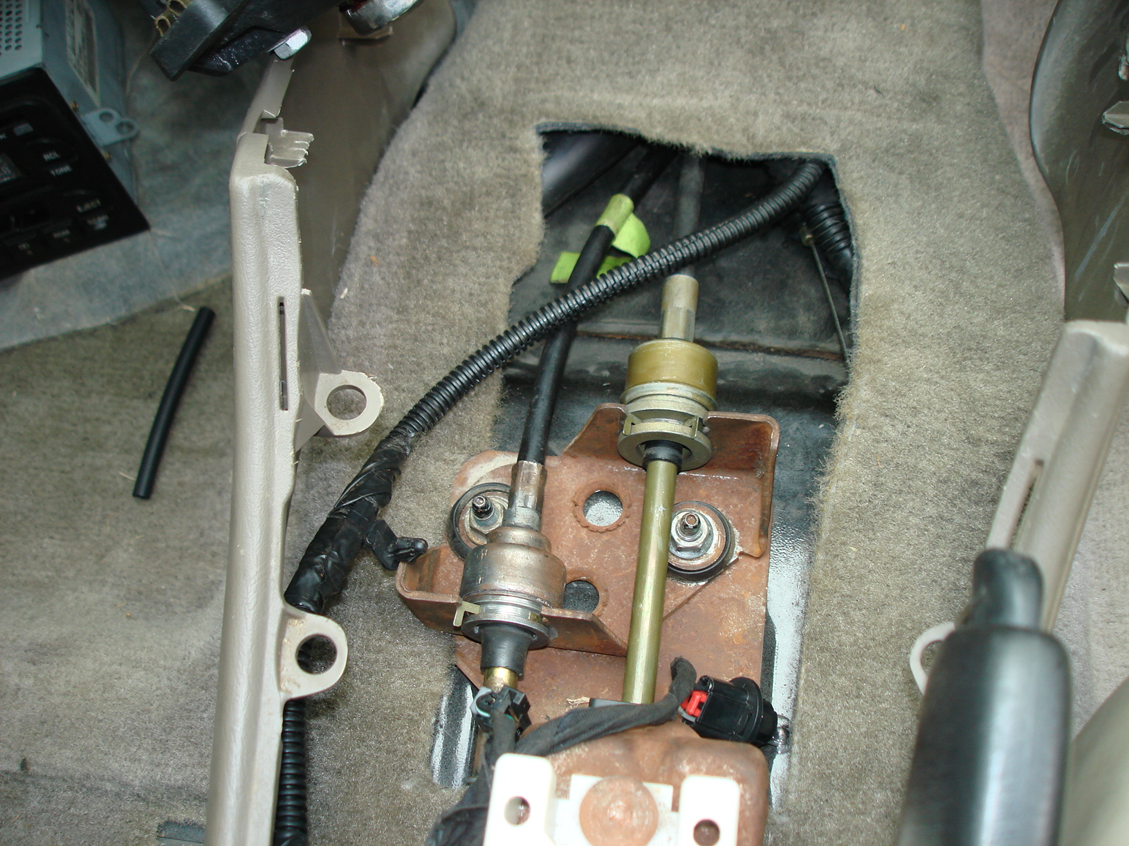

                        Some update,
                        MMm just recieved my costume shift cabels, I will be posting some pic's tomorow. Waiting on the orig clutch padel from alero/grand am.

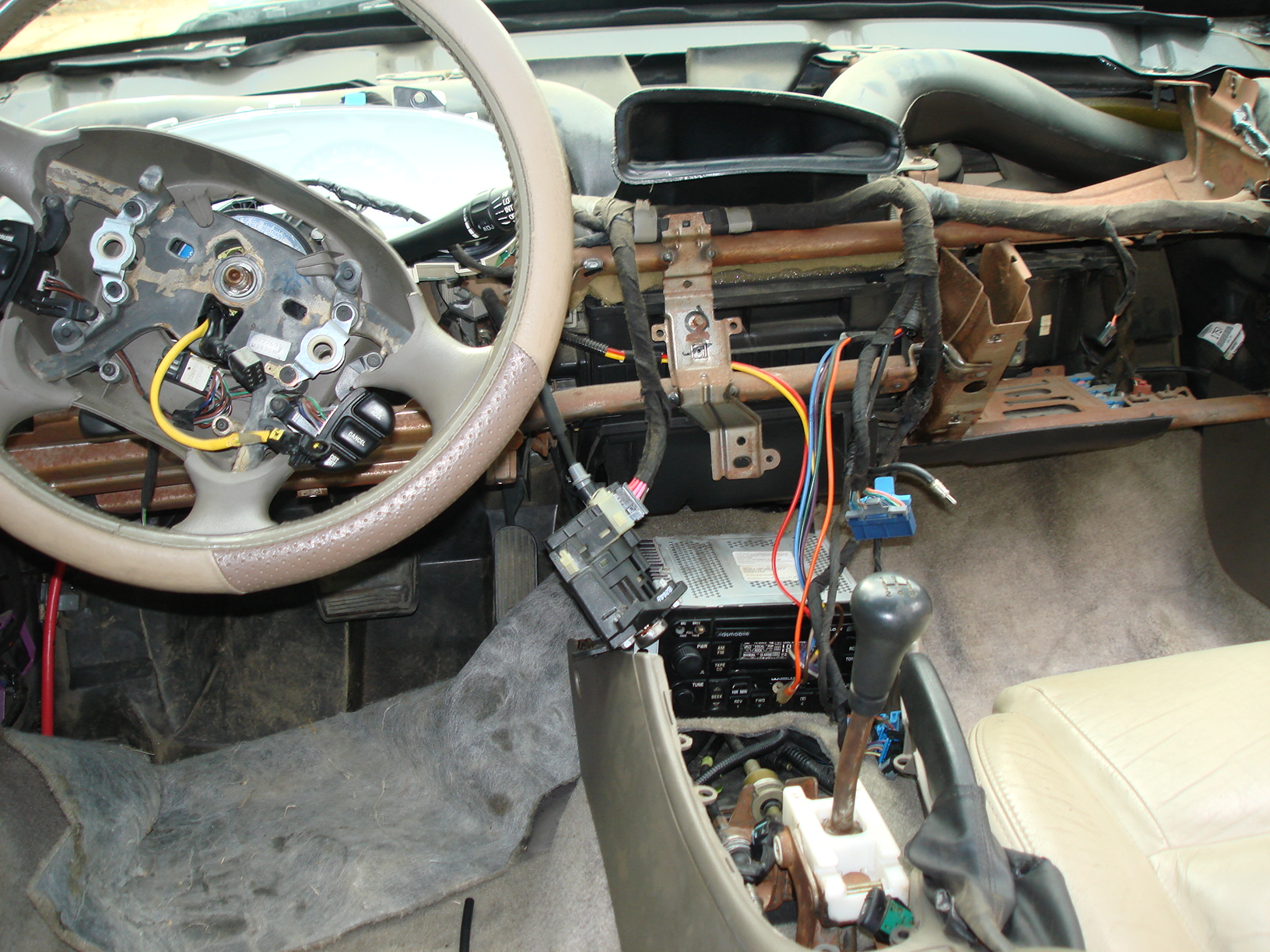

                            Some update pic's.
                            The car isn't still ready, still waiting on the clutch padel, It's on back order so say's the GM dealer.

                              Next step is installing the Microtech ECU LTX12s, with a extarnal crank trigger.
