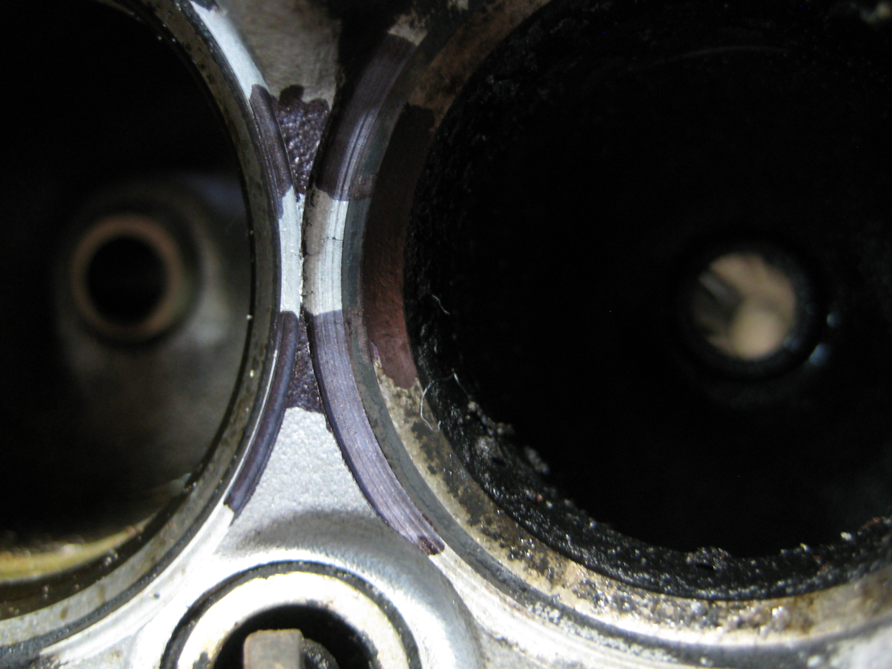

WOT-Tech needs 10mm 3400 heads
    • 13522
    Go another set, which looked like it was involved with a lower intake gasket leak. After cleaning them up, yet another cracked head So far I am 1 for 4.

        You can always repair them by TIG welding. May have to preheat them quite a but to avoid cracking.
          I was just going to suggest that as well.. make John weld them up. lol
            Live life 3.7mi at a time
            • 4555
            I wouldn't waste my time/money/effort to weld them. The valve seats would have to be removed, welded, machined for new seats and new seats installed. At that rate it would be cheaper and/or easier to buy new castings lol.
