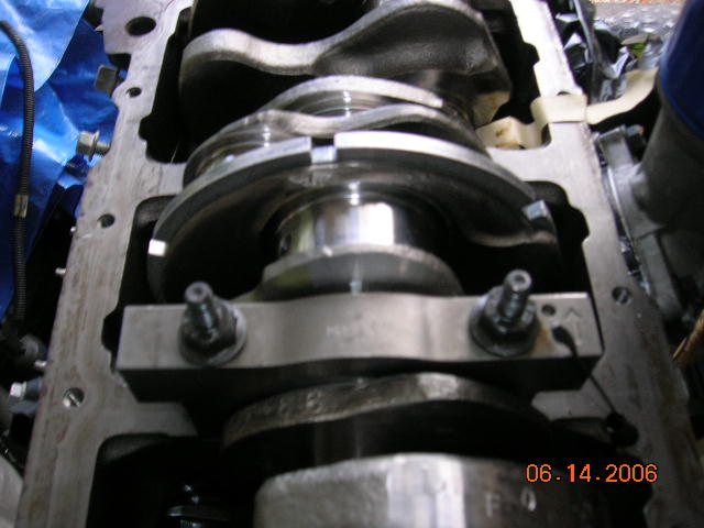

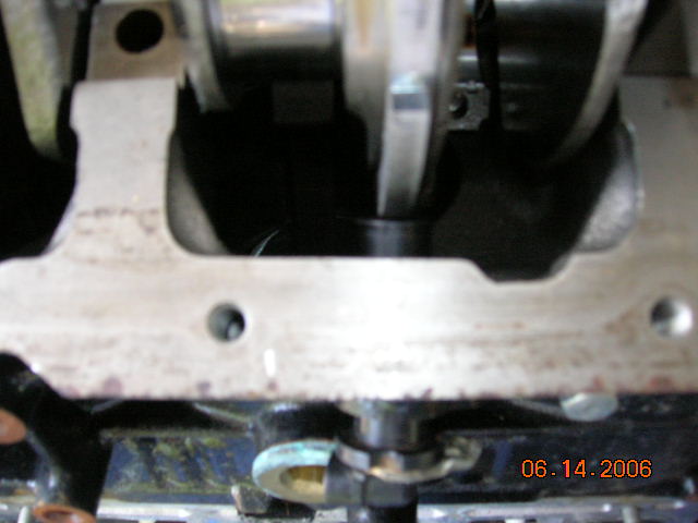

          So far it looks like I'll just need to have the inner diameter increased. I have an oscilloscope, what a blessing, I wasn't even looking for one at the time but an unscheduled visit to a good and long time friend who happens to have all kinds of goodies pulled one out of his stash programmed to test all of the sensor wave forms among other things and let me borrow it for a while.
          I don't have my simple but effective camera so the shot of the sensor next to the ring in the block is not as clear as I would like. This is about as much as I can do until the end of the month.

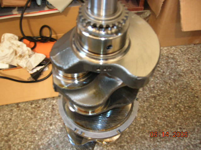

          That's a steel crank

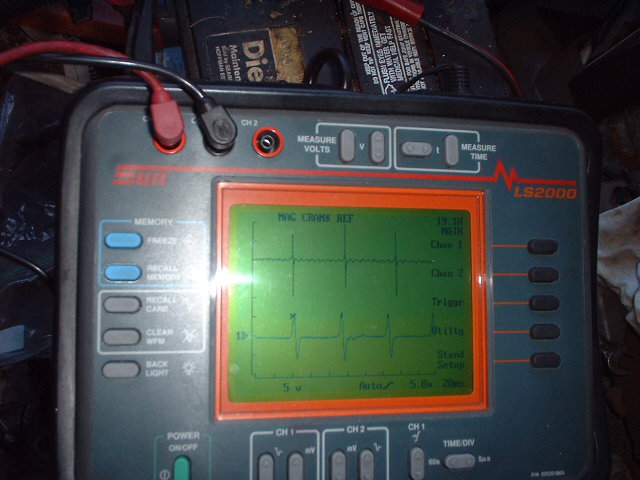

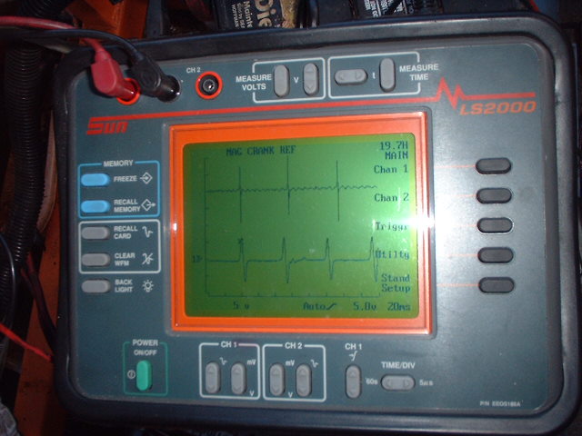

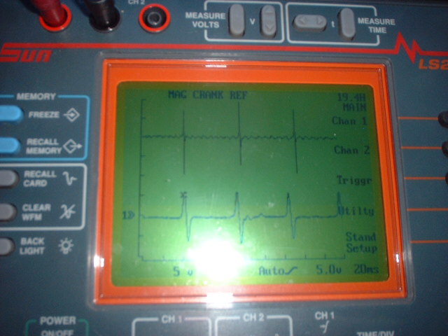

            First Oscilloscope test results
            So far so good, I plan to perform the same test on a 3.4L I have in the yard although that might be somewhat cumbersome and time consuming it would be a good comparison. The ultimate test will be connecting the ignition system and looking for the appropriate spark.
            The bottom wave form is the crank trigger reading the top is example. My guess is that the faster the crank spins the narrower the wave form. I still have some tweaking to do since I have not made the spacer yet to assure an approximate .050" From the crank I'll have to check my GM manual I think that's what it's supposed to be.
