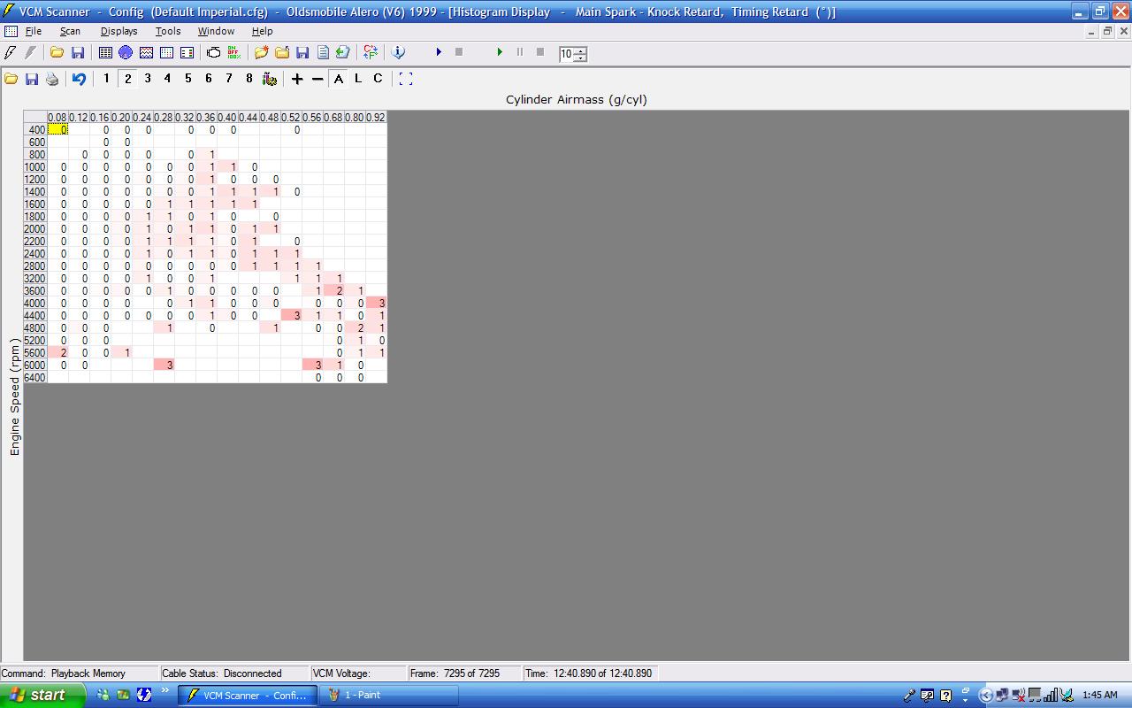

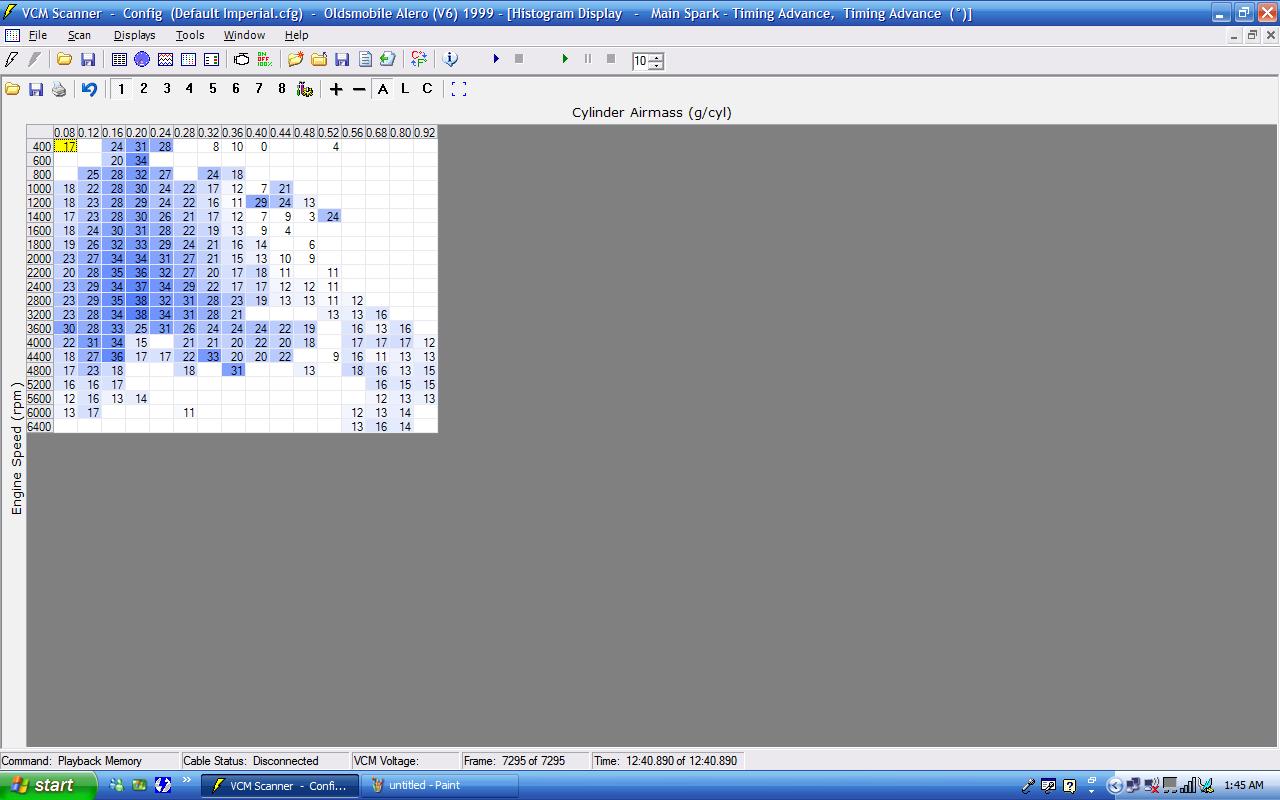

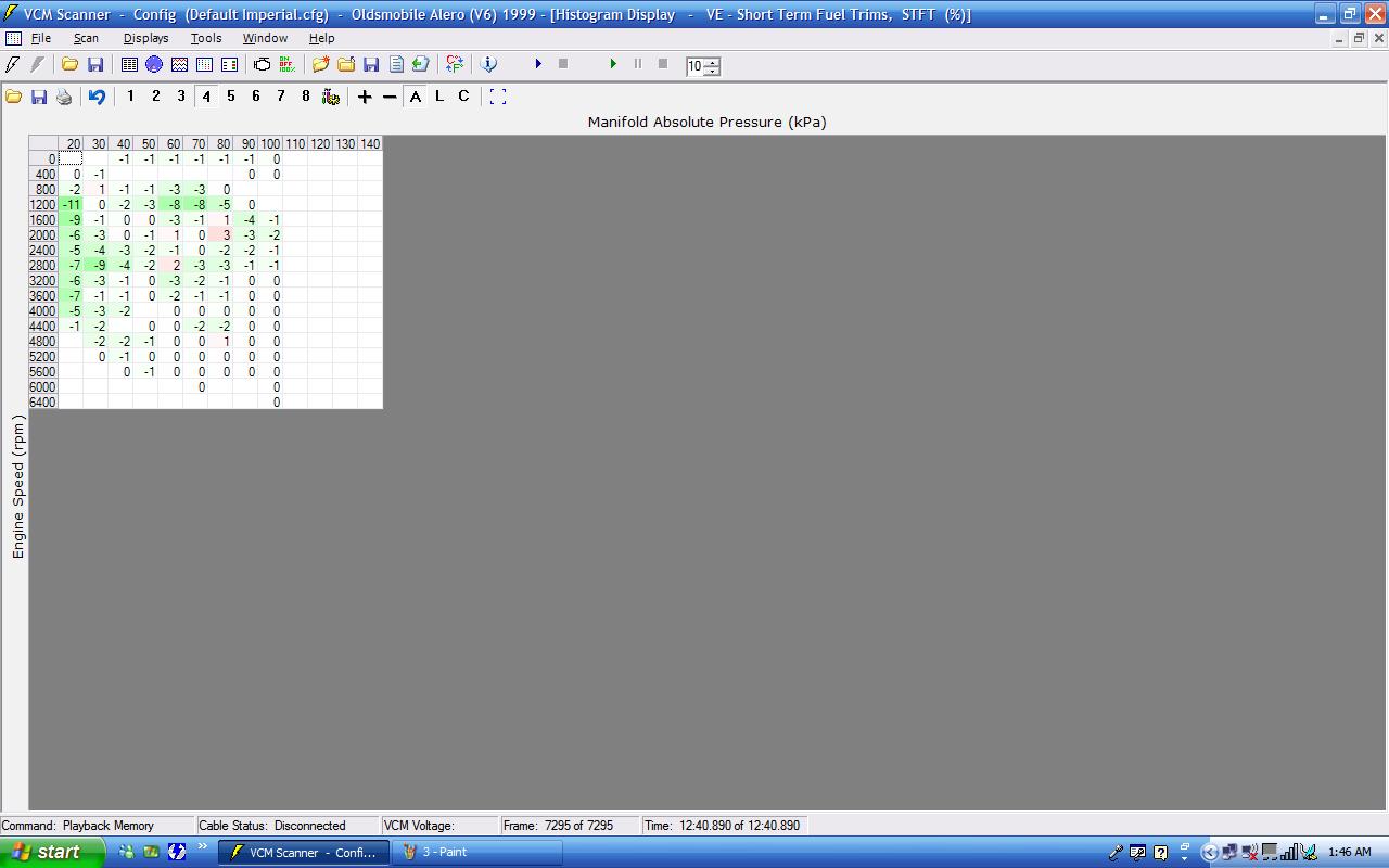

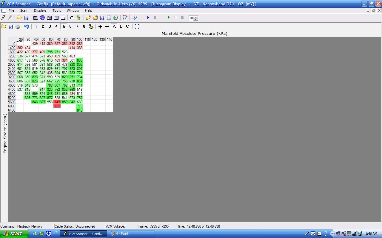

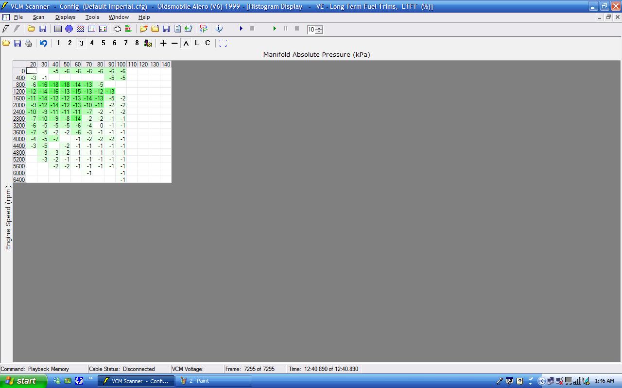

                        MM just made a test drive to day again, made some new tuning. It's running like hell yeahhHh , now for fine tunning ihih , est horsepower will be 400 Fwhpower.
                        Mm can some one that has the HP tuner help me here's some pic's of the scans during drive

                              Cool, nice engine.Well it's not a prob it's just you need to get @ the program, Hmmm it's going better not the best but better. Hmm the car made 300 Whp @ 5 PSI boost on tuned. So say's the gauge that I have(AeroForce Interceptor )if it's accurate lol.
                              It need alot of tunning because right now it's running lean, and some times it runs rich.
