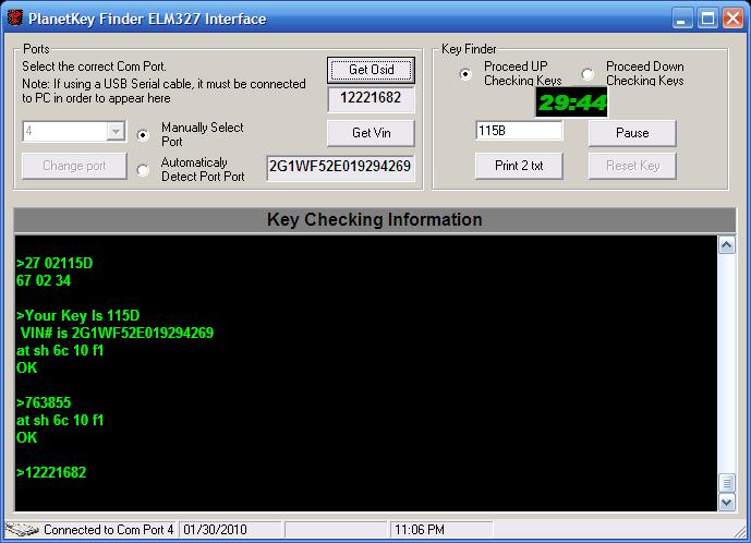

                Well, I have been successfully in writing the App to get Seed & Key!
                Also (though many have told me the ELM can't get the Osid) I can retrieve the OSID and Vin of the PCM!!!!
                Here is a SS
                Let me know if anyone wants to try it out!!!

                  #38
                  i have no idea what OSID is, but i am interested...
                  i can use my ATX power supply and give the PCM 12 volts and go through what i think may be the correct set of hex digits...
                  may be able to get the OBD1.5 tuning ball rolling...

                    #39
                    I think OSID is Operating System ID? I know it is the PCM ID
                    example = the OSIDs that DHP supports http://spreadsheets.google.com/pub?k...n1_K034oyJoMUQ
                    My OSID is 12221682 which is if you look at that chart from a 2001 3.4 Impala, which is what I got the PCM from.
                    I am inputing some different commands here and getting some interesting results.
                    The Elm327 doesnt do highspeed so thats next on my list, but I am going through some commands that a found in the HPTuners archive
                    Make sure key is on Position, engine off.. and enough battery power.
                    Disable normal message transmission on all nodes
                    Send: 6C FE F1 28 00
                    Rec: 6C F1 <active node> 68 00
                    Read Seed - Data Link Security Access
                    Send: 6C 10 F1 27 01
                    Rec: 6C F1 10 67 01 <2 byte Seed>
                    Send Key - Data Link Security Access
                    Send: 6C 10 F1 27 02 <2 byte Key>
                    Rec: 6C F1 10 67 02 <Sucess status?>
                    Request High Speed Mode From All Nodes
                    Send: 6C FE F1 A0
                    Rec: 6C F1 <active nodes> E0 AA
                    Begin High Speed Mode
                    Send: 6C FE F1 A1
                    Rec: 6C F1 <active node> EF
                    Scan Tool/Test Device is Present
                    6C FE F1 3F
                    <DOWNLOAD BOOT LOADER>
                    Request Upload
                    Send: 6C 10 F1 35 01 <2 byte size> <3 byte start address>
                    Rec: 6D F1 10 75 01 54 (Request Response)
                    Rec: <Data block>
                    Send: 6C 10 F1 76 00 54 (Block Transfer Response OK)
                    Repeat
                    Return to Normal Mode
                    Send: 6C FE F1 20
                    Rec: 6C F1 <active nodes> 60
                    Without HighSpeed I know I can not flash, but hoping to be able to dump the bin from PCM with the Elm327
                    Maybe dimented24x7 can chime in here

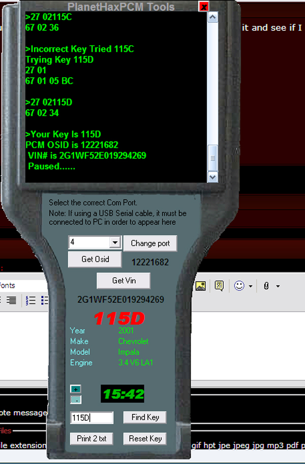

                                #45
                                Hehe, well had a free hour this aft, so added a seach of .xls file to get Veh info cross referenced by OSID, and change the look of the Form a bit.
                                What do you think?
                                (will upload latest version later this evening)
