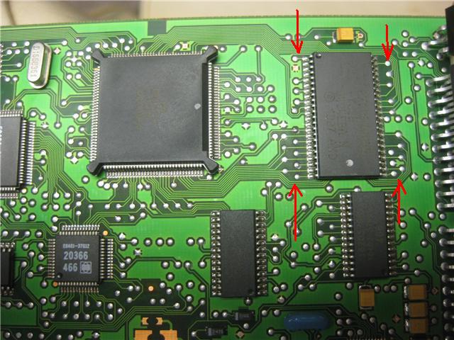

                        I talked with my CE/EE buddies last night, and we might be onto something. Check out the picture of my PCM & chip. We started reading the AMD chip literature & matching the reprogramming pins of my chip. What we realized was an interesting phenomenon - the exact pins needed for a reprogramming the chip are actually already exposed in the board as dabs of solder in 2 rows a few mm from the pins (see arrows of the rows in the pic). Maybe it's a PCM manufacturer debug or manufacturer's reprogram without removing the chip? I'll bet there is a manufacturer's fixture that fits over the chip that directly makes contact with the dabs of solder for this purpose. So, my next thought is to take an empty bread-board and cut or machine out a hole for the chip. Then precisely place contacts on the underside and wires through the top side of the board. When you want to reprogram, just simply place the jig over the chip and bingo - your pre-made jig contacts hit the mating PCM board contacts. No soldering needed! (unless you want to solder wires directly to the PCM board). I'll have to talk with my CE buddies and see if they can program something in C++ to directly JTAG the IC through this jig. The only problem is it may be difficult to find a computer (we all have laptops) with a serial or parallel port for easy JTAG. That's where the USB programmers already pre-assembled make life easy. This is all just a theory, but could be something worthwhile. My EE buddy is going to ask his professor that is well-rehearsed in everything IC for his thoughts.

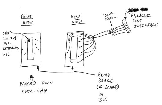

                            Thanks for the site. I was originally thinking of going this way until a few problems came up. First, my chip is surface mounted. Most of these adapters have thru-pins to be soldered through. Secondly, the soldering part scares me the more I think of it due to the solder reliability. Third, there is not a lot of real-estate around the chip for a larger adapter to be mounted.
                            I made a quick-and-dirty sketch (attached) of my idea above. I hope I didn't over-simplify the device. It might become more complicated as issues arise. The biggest positive attribute is it doesn't require any soldering or modification to the PCM at all. If you happen to interrupt the flash and the chip is junk, just buy a new PCM at a junk yard for around $30 range. Plus they even give you 30 days warranty so you could always swap PCMs if the chip goes null. This concept has a few potential assumptions or flaws: I need to check feasibility with an IC guru if this chip can be JTAG'd which therefore assumes just 100 ohm resistors are needed through a PC parallel port (and applicable software which is just a mod of what's out there already). Also, I assume the chip can actually be programmed in the unpowered PCM board (besides the applied Vss and Vil voltages) without other component resistances interfering. Finally, the AMD specs don't mention JTAG pins, just write/erase pins which make the PC interface potentially more complicated and gives more potential for the chip to HAVE to be removed. This doesn't mean it can't be JTAG'd, but just complicates the process. But again in my chip picture if you follow the wire leads in the board, there is an interesting pattern in the row I highlighted since the leads don't stop at the solder points (they continue on through to the next chip). Unless they go through to the underside of the board (which is difficult to identify), why else would they be there? I have to talk with some electronic or IC experts further.

                              I know in the PCMs I have, just about all the address lines are available as soldered terminiation points for factory testing. My vortec PCM has three long rows of such pins that connect to most of the MPU and flash chip, so you should be able to make connections at those points as well, once you find them.

                                Im not a hardware expert, but as for programming, the flash chip's write functions are activated by the WE/OE pin states, and the write protect pin. If the correct voltages are applied, the integrated controller will then accept write commands through the lower 8 bits of teh data bus, if I recall correctly. Bascially, the chip is programmed serially with command bytes and data bytes defining the address and data to be programmed (normally sent by the MCU). The chip also needs a steady bus frequency to operate, so if you want to do something like that, you will need to provide it with just about all the signals it would need to normally operate within the PCM.
                                Another thing to look into might be backround debugging mode, which is supported by the 683XX MCUs. There used to be info on diy-efi.org for doing this with the earlier vortec PCMs. I dont know if your MCU still supports BDM, but its worth looking into, and easier than what your currently trying to do.
