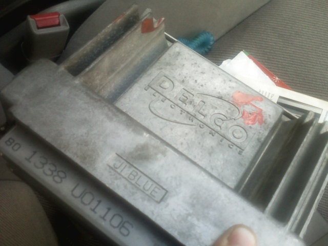

            yeah, ill have to get a pic of this ecm its odd looking, i looked at a few other '97 ecm's they were identical to mine...this one was not, i dont know what the differences could be but im not even going to bother with it, im going to just get another '96 and start with that since the pinouts are the same and obviously monkey'n around with that is alittle outta my league at the moment. trial&error

              here it is

                That is not a 97 venture ecm... that's something else. Do not use it again. Get the 97 ecm that ends with 058 in the service number. Its very easy to find the right one.
                Ventures don't have VATS enabled by default anyways so that's not an issue.
                Also why do you need the vin?
                You need to get the supported Venture bin file that's on the powrtuner website so you have a file you can flash, but before you even do that you need to adjust the fuel injector flow rate otherwise it will not run right, and you will need to adjust the trans tables so it will shift properly.
                  thats so weird, its possible the yard marked it wrong though, ive seen '99 berettas there before lol.
                  in any case.. youre saying i need to make those changes to the bin file in DHP BEFORE i do a full write. i have the stock '96 file so i can basically use that and copy those values into the '97 file, then do a full write.
                  thought i might need the vin in case there was an OSID problem
                  also i looked over the 058, that would have saved all of it right there. i have a thread you posted bookmarked for ref. so its a huge for me. i hate feeling like im wasting anybodys time.
