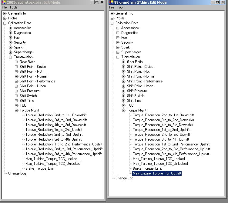

                Ok i see the table your talking about. tq reduction... it is a percent. i dont have a 2002 file but i have a 2003 file and it doesnt seem to have the max tq for upshift table. i have a pic of the two bins th other is a 99 and it has the max tq table.
                for the table you are looking at 0 percent would remove no power. so you would want to lower the numbers but for safety sake i wouldnt change them. if you do your shortening the life of your trany.
