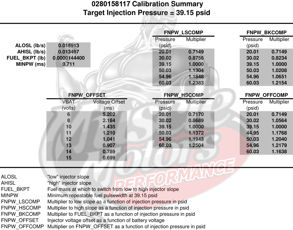

                          Also it's good to keep in mind that dead times vary not only with voltage but also with fuel pressure. So if you're running injectors at a different pressure than stock the dead time table may need adjusting as well

Name:	Injector Spec Sheet.jpg
                            These are the settings for my injectors. In my case I didn't initially realize that fuel pressure had to be accounted for to get accurate dead times. I didn't end up with a smooth idle until I finally realized that and adjusted the times correctly. They weren't off by a huge amount but it was enough to cause me huge problems with idle and low rpm driveability.
