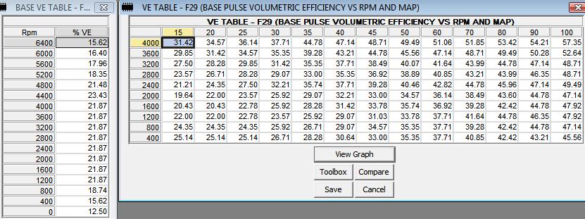

                the bcc i pulled these from is bcfa, which is the last 3.4/manual tranny bin made.
                i don't know what all other tables you might need, but these three should solve a lot of problems. i don't know if haltechs use a ve adder table, but if not, just add the two cells together and that should get it right.

                    Alright, thanks a bunch for the tables.
