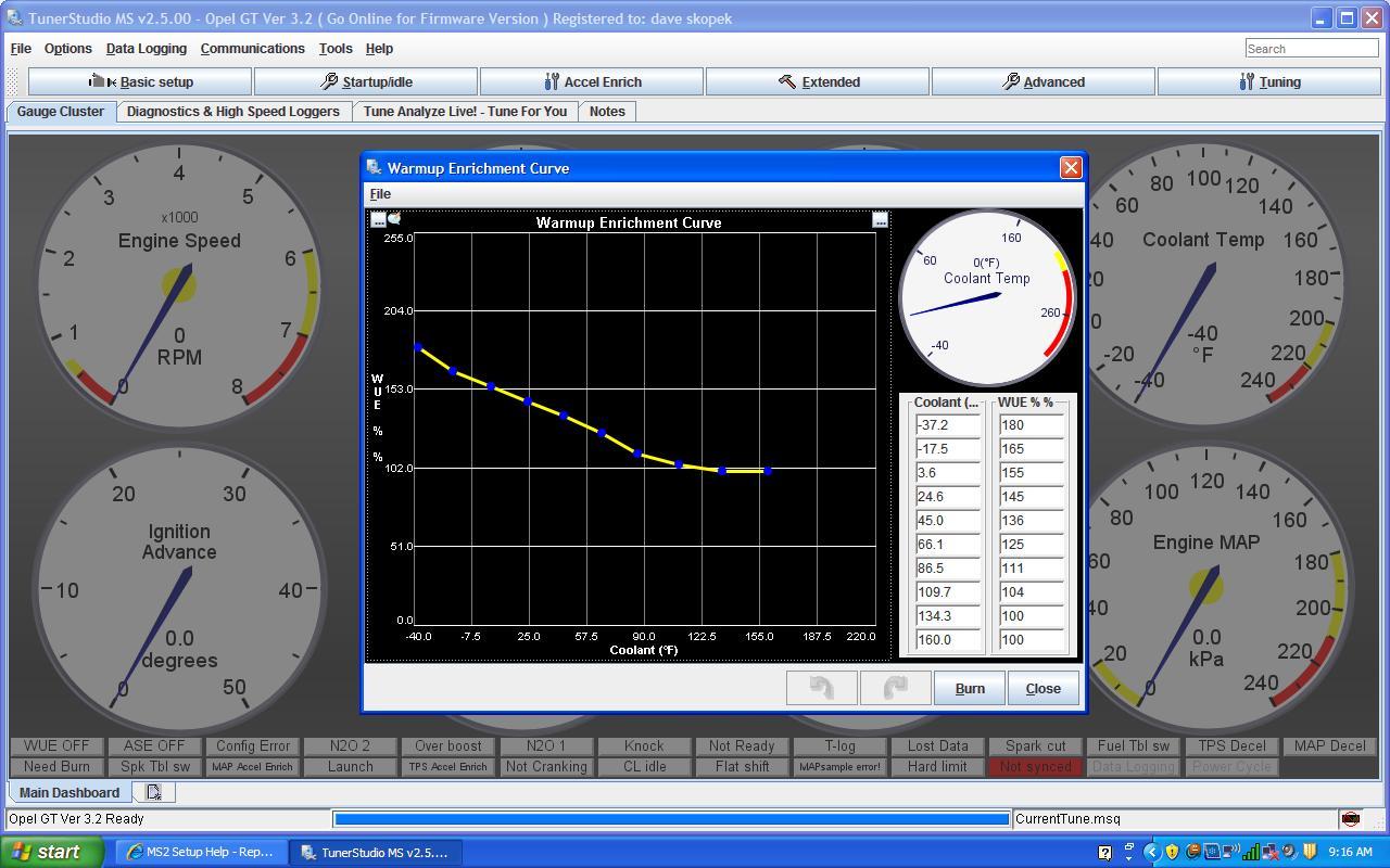

                  • dskopek
                    • Jul 2009
                    • 124
                    #69
ID:	377670warmup_curve_2013-12-30_09.12.46.zipIt should shut off when you are no longer adding any fuel, in my case it is 135 degs. thats when my table settings = 100% means i am not adding or subtracting any fuel, just running off my fueling table only. Check your warm up table and see where you get down to 100%- thats where the warmup should shut off.
                    • Maverick H1L
                      • Jan 2010
                      • 230
                      #70
                      WUE is set to shut off at 160-165 or thereabouts (at 100%). From what I understand from looking at the laptop during starts, the MS is using the WUE as ASE on hot starts, which is completely idiotic. Neither is supposed to be on period above 160-165, so why is WUE turning on as ASE at 180+?
                      Still can't seem to get the AE right... I think it's set around 4ms or so right now and I still can't tell if the engine is being flooded or leaning out when I get in the throttle hard above First gear...
                      • 90BlueZ
                        • Jul 2006
                        • 83
                        #71
                        WUE is not used above 160 if you have the 160 bin set to 100%... Look at the WUE gauge on a hot start, it should be at 100%. ASE is something totally separate from WUE.
                        EDIT: Actually, I think the WUE gauge include ASE, but just remove the ASE if you don't want it, they are separated...
