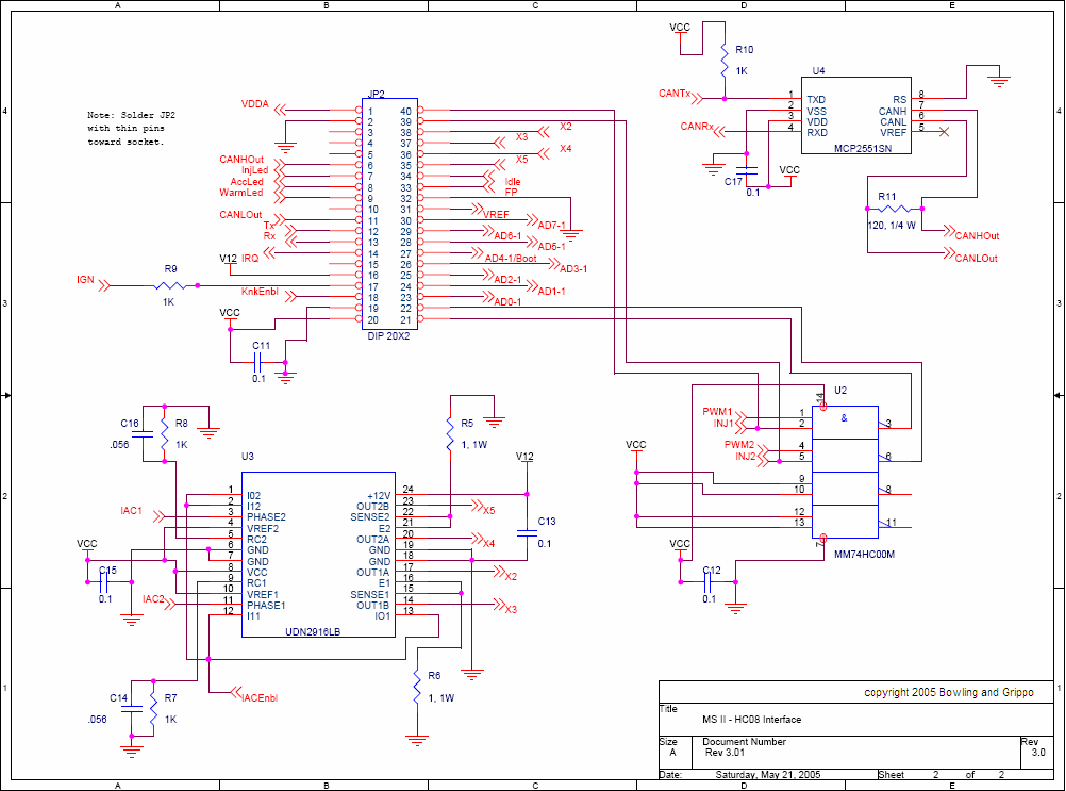

    Well, I've finally solved the riddle of the IAC. There are 2 large resistors on the bottom of the MSII daughtercard that need to be bypassed. I just haven't gotten around to it yet. This info was found on the MSefi MSII IAC page:
    "For some IAC stepper motors, you might need to make some adjustments because the power resistor values may not be quite low enough for your application. This could cause sporadic problems. To see if this is the problem, cut the leads off a resistor or use a small piece of wire and solder it across the two power resistors on the bottom of the your MegaSquirt-II™ controller board. (That is, jumper each resistor separately, don't jumper one resistor to the other resistor.) These are the two large brown units on the BOTTOM of the board, on the end opposite the side of the board with the 2x3 pin header (typically they are marked 1R0). These have large solder pads on each side - just jumper across each one so you get 0 Ohms across the resistors and see if this improves operation. If it does, leave the resistors and jumpers in place. This is very likely to be the problem for those who see the proper step commands given in software but inconsistent response from the motor, such as requiring a restart to lower the hot rpm after a cold start."
    FYI, the power resistors on my daughtercard are BLACK and read "R00".

      i could be wrong, but R00 should be 0 ohm resistors already.... perhaps take a multimeter to them to verify?

        According to the MSII daughtercard schematics, R5 and R6 (the 2 resistors in question) are 1K, 1W resistors.
          1 watt is an odd power rating for a 1k resistor, and the IAC control is not on the MSII daughter board... do you mean on the main board? On the 3.0 board, or 2.1 and 3.57 boards for that matter, R5 and R6 are not 1k/1W resistors... on my 3.0 board, R6 is 10k/0.125W and R5 is 2.2k/0.25W. R39 and R40 are 1 ohm and rated for 0.5W... I believe they're related to the IAC circuit as well, is that what you meant?
          1R0 is 1.0 ohm.
          R00 is a jumper/short.

            No, I'm talking R5 and R6 on the bottom of the MSII daughtercard, the opposite end of the 6-pin connector. On the underside near the B/LD jumper pins.
            That doesn't make sense that the resistors would have 0 resistance. Then they wouldn't be resistors. What also doesn't make sense is that the resistors on every other daughtercard would be 1K ohm resistors and mine would be jumpers, with the card as it came from the assembly line.
            I'm attaching page 2 of the MSII daughtercard schematic you you guys can see what I'm talking about. And also the pic from the MSII IAC page that shows where the resistors are. The yellow circles to the right of the resistors in the pic are the terminal blocks that plug into the 40-pin IC socket. In the schematic, R5 and R6 are on the right side of the IAC driver, the UDN chip on the bottom right. They are between SENSE pins and ground.
            I'll check the resistance of them the next time I have to drop the ECM out. Right now, it's going to stay where it is due to the connection issues that seem to come and go as they please and they seem to be gone for the moment. I'd rather not disturb the harness right now.

              R00 is indeed a "resistor" of zero ohms, used as a jumper in a circuit that could be populated with a variety of different values, where a jumper is needed sometimes.
