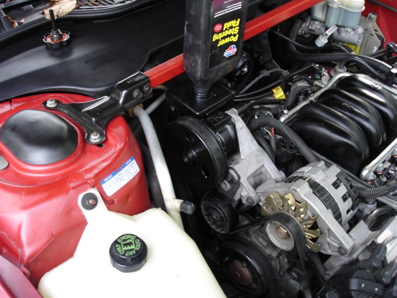

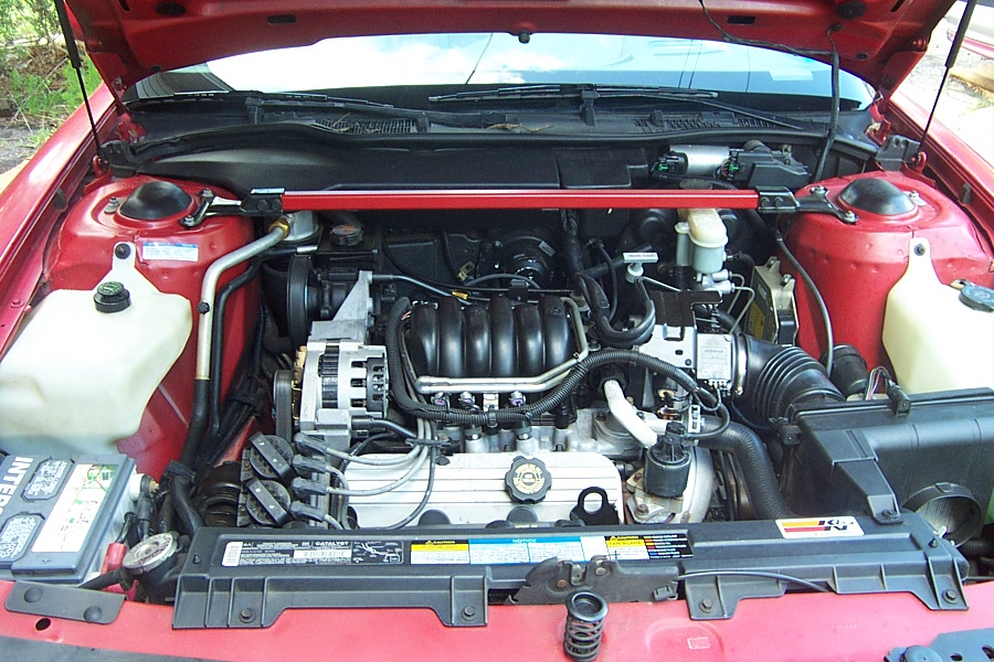

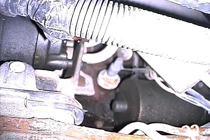

                    Just so you know Josh, the ECM in 92-95 Bonnevilles is in the passenger footwell area. The 94-95 Bonneville had a smaller Memcal with EEPROM instead of the Regular Memcals with EPROMs found in many other GM's. Although I'm not sure you'd be able to run a 3400 with the 3800 ECM. The C260 (The connector with wired from the ECM to the engine) is right behind grommet 102, which is behind the a/c accumulator.
                    If I were you, I'd do away with the ECM inside the car and move it to the airbox area. GM did this themselves in 1996.
                    And you're correct about the L27/LQ1 mount being in the same spot on 1st gens. Now there isn't a mount in that spot in that generation H body. Although the 1st gen H body DID have use a mount in that spot and GM kept the provisions for that mount on 2nd gen H bodies. So you may be able to use the LQ1 engine mount. And you're correct about N bodies having the torque axis mount. My dad's 94 Corsica has one as well. I actually would try that route first. I would not recommend putting a dogbone on the radiator support. It isn't NEARLY as strong as W Bodies. That is, unless you reinforce it.
                    I included pictures of an H-body torque axis mount (you can kind of see it), The L27 engine mount in a W-body, and a Picture showing the area where the C260/P102 is located, and pictures of a 94 3800 Memcal.
                    -Sean
