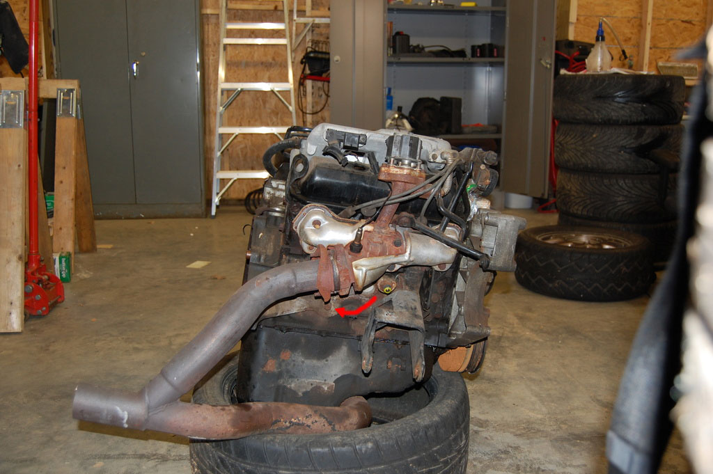

What is the sensor that is just under the exahust manifold in this picture? You can see it has a little yellow tip.
The reason I ask is because when using the jeep motor mounts there is not room to put this sensor on the engine. Can I get around using this sensor? Would a previous year ecm not need this sensor to operate? Please let me know some info and information. I am thinking it is some sort of knock sensor, and I am afraid if I cannot plug it in the ecm will retard timing and run is safe mode all the time. Does another vehicle use this same sensor but with a narrower profile? Thanks for any help.
I believe you'll want the knock sensor. Even my TBI 2.8L with distributor has a knock sensor. How bad is the clearance issue?Last edited by Canyonero; 05-13-2008, 11:26 PM.'98 Volvo V90 - Ford 5.0 swap in progress
I may need to try to bend the motor mount then. I don't think its going to go in the way it sits. Do you know if any other knock sensors have a narrower profile that accept the same plug?Originally posted by Canyonero View PostI believe you'll want the knock sensor. Even my TBI 2.8L with distributor has a knock sensor. How bad is the clearance issue?
I didn't get a chance to work on it tonight, but it really does not want to fit. You need to remember that I am not using the mounts pictured. Those are the camaro mounts. I am using my stock jeep mounts.Originally posted by Canyonero View PostCan it simply be moved to another boss? I really don't know, but it looks like it would fit here:
