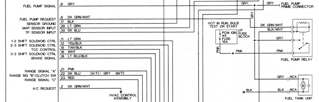

      There are two wires from the ECU that should connect to the fuel pump circuit. The fuel pump relay control is Dk Grn/Wht (Pin 8 on ECU connector "A", the grey one). Be careful, because there is another Dk Grn/Wht wire on that connector for the AC system (pin 2). Another connector also has two Dk Grn/Wht wires, for the canister purge and the AC Compressor. Sooo, enjoy.
      The ECU also wants to know when the fuel pump is actually running, so there is a Grey wire (Pin 6 on ECU connector "A") that should be wired into a tap coming off the hot side of the relay, the wire running to the fuel pump.

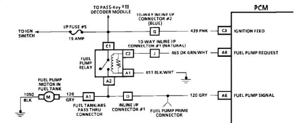

            Okay let me make sure we are on the same page. Here are the install instructions on the fuel pump relay kit I bought http://static.summitracing.com/globa.../prf-50102.pdf
            The fuel pump relay control is Dk Grn/Wht (Pin 8 on ECU connector "A", the grey one) So y ou are saying this wire should connect to the 18 gauge yellow white wire talked about in step 3? Then you are saying that the Grey wire in Pin 6 A Should be connected to the 12 gauge Yellow/white wire talked about in step 2? Let me know.

              Yes, sort of. The 18ga Yellow/White will connect to the Dark Green/White, the 12ga Yellow/White will go to your fuel pump like it says, but you'll also want a small gauge tap back to the ECU grey wire. It's just to inform the ECU that the relay is indeed working and the fuel pump has power, doesn't really need to carry current per say. 18ga would be fine for the tap and it could come right off the relay where the 12ga connects.

                Okay, I am almost done on wiring the fuel relay, I have hooked up everything I can with out having the battery in the vehicle. But I am still not clear on what you are talking about taping the fuel pump turn on line...but not really tapping it. Either I can hook into it and that will draw current or not. I don't get what you are saying that I don't need current per say.

                  I'm just trying to say that the ECU isn't going to draw the same amount of current as the fuel pump is. You want 12ga to the fuel pump, but the lead going back to the grey wire on the ECU can be 18ga. Look at the attachments, should be able to see what I'm talking about:
