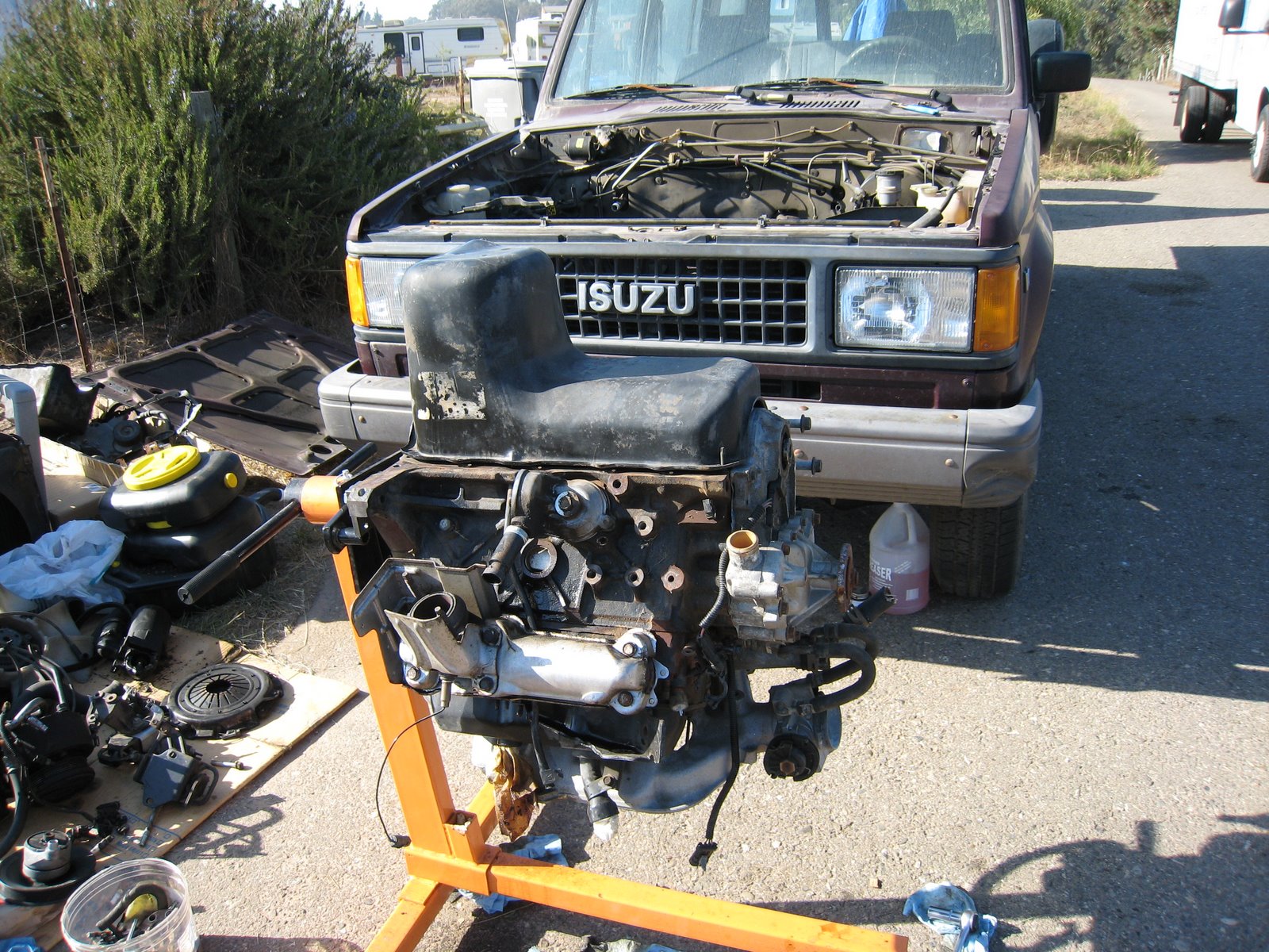

        The 4x4 pan is shallow in the front to clear the axle but has a very deep sump at the back of the engine. See the attachments (borrowed from another member's Trooper swap). Again, I must say that I don't know for sure that Jeeps are the same way. I just know that Troopers and 4x4 S-10s are.
