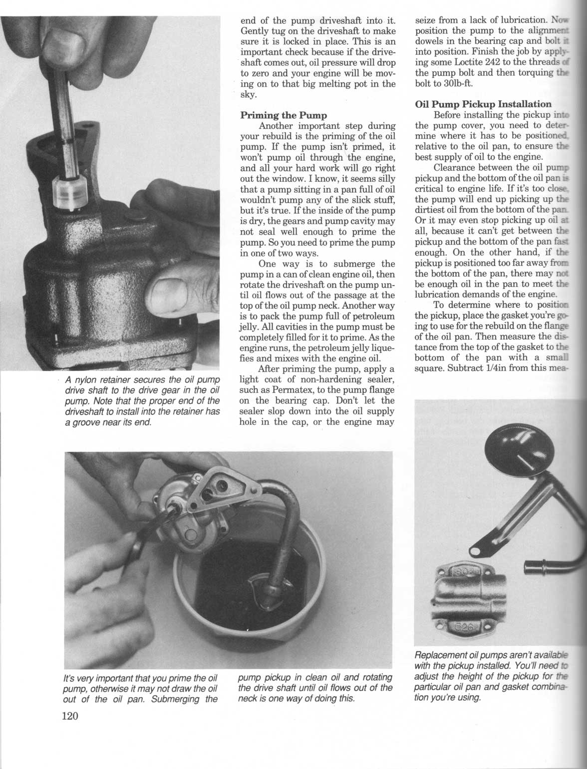

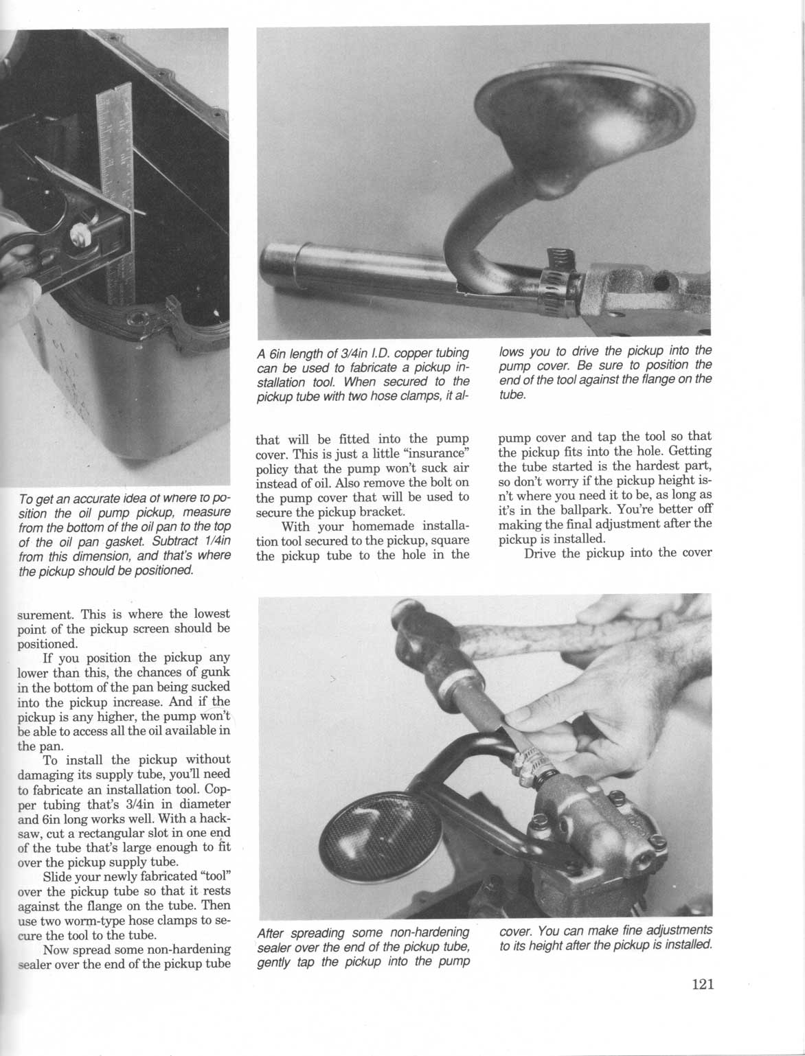

    I took mine to the local machine shop, they had the official Melling tool to hammer the pickup in. The guy charged me $5, and talked at me for about a half hour about oil pan baffles and the history synthetic oil.
    One of my manuals has instructions on how to make a tool to drive the pickup in, I haven't tried it. I'll try to get a scan of the page later today, but you might just want to call your local machine shop and ask. It's a simple job and using the right tool is usually the way to go...
    If you can find out what the tool is I would appreciate it. There is not a machine shop in town so I would have to go out of town to get it done.

      I don't know where to get the real tool, or if it's worth it.
      Attached are the pages covering the pump install. This book is out-of-print. If I'm not supposed to post stuff like this because of copyright, go ahead and take it down.
