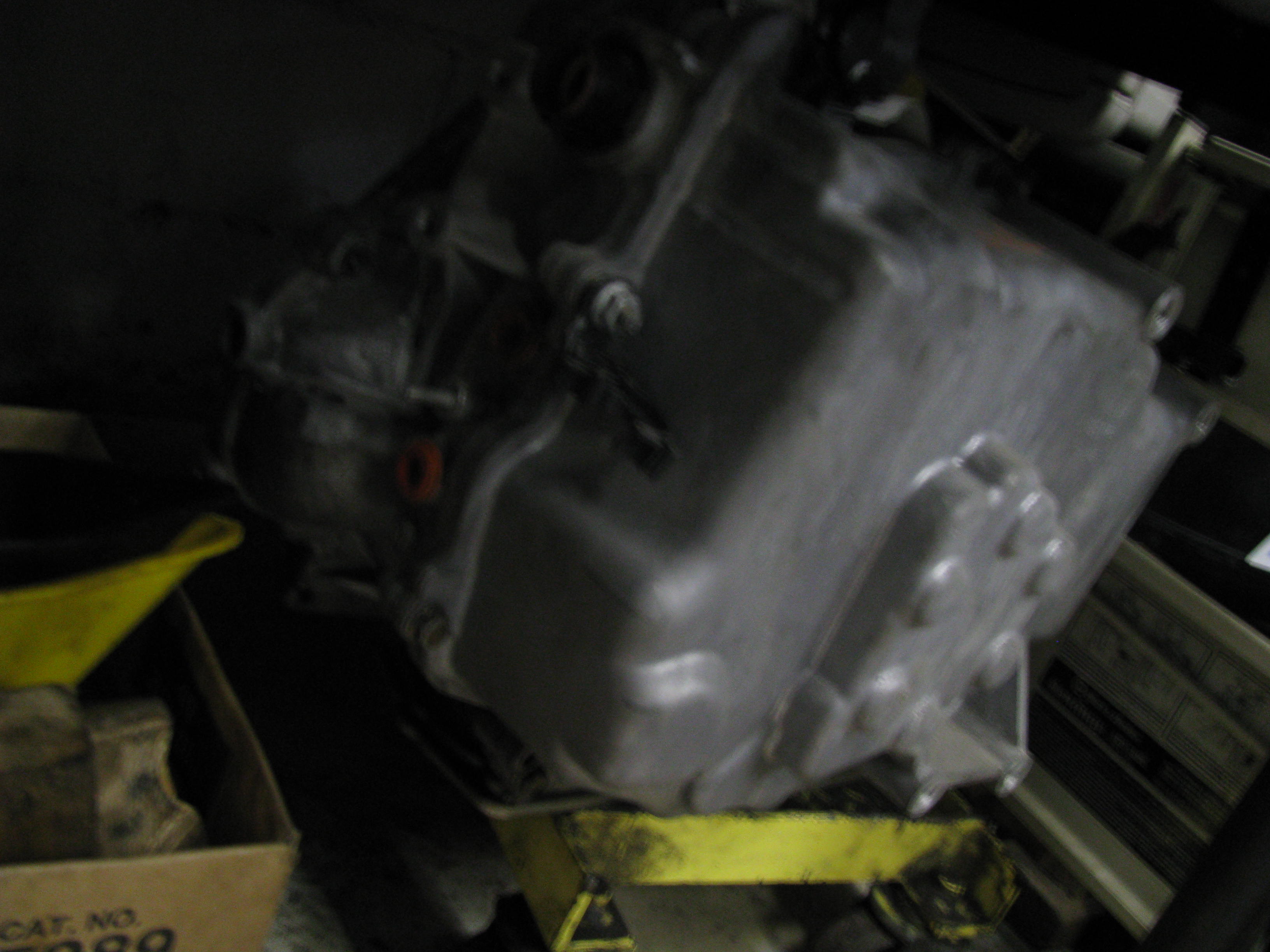

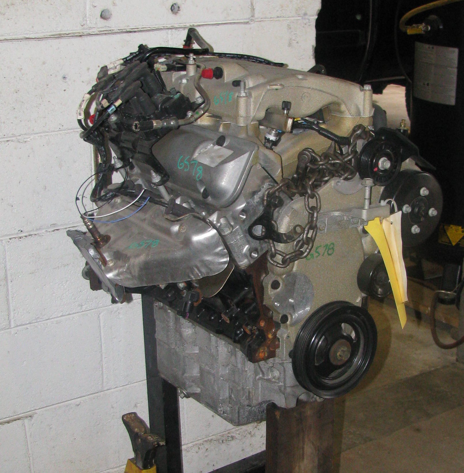

                        Added a picture of the 3500 and 4T45-E. I'll have pictures of the install too.
                        The 4T45-E is a bad picture. I'll have some better ones in the next week.
                        Hopefully the week of the 8th the install can get started and I'll post pictures
                        for those considering a 3500 swap.

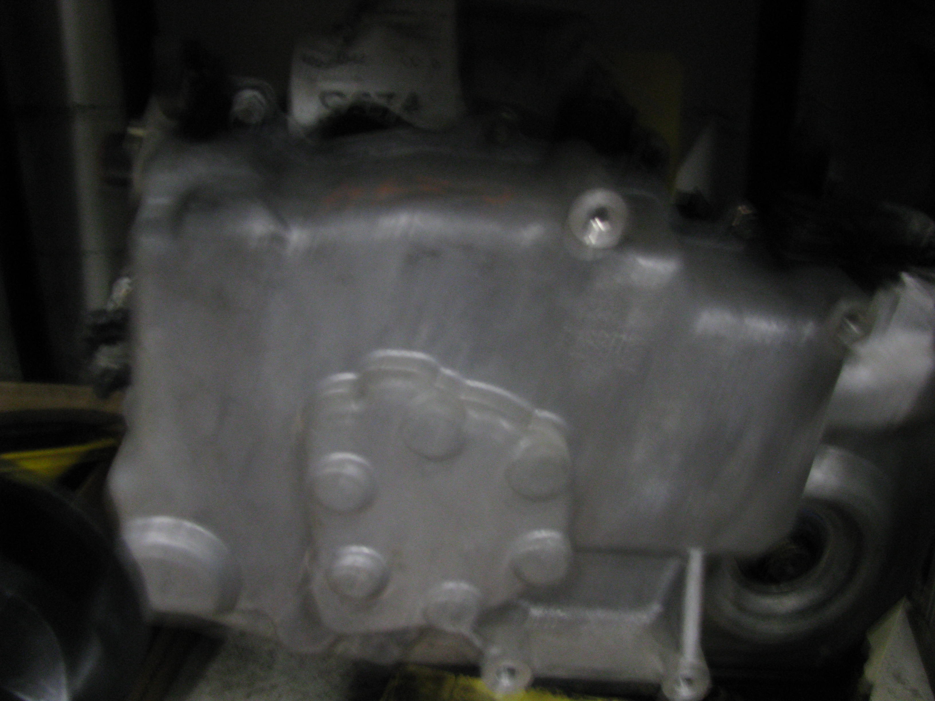

                          What year, make and model is that transmission out of?
                          From the side shot it doesn't look like it is going to work in your alero with out some modification.

                            The transmission is from a 2005 Grand AM GT.

                              Here is another shot from a slightly different angle.
