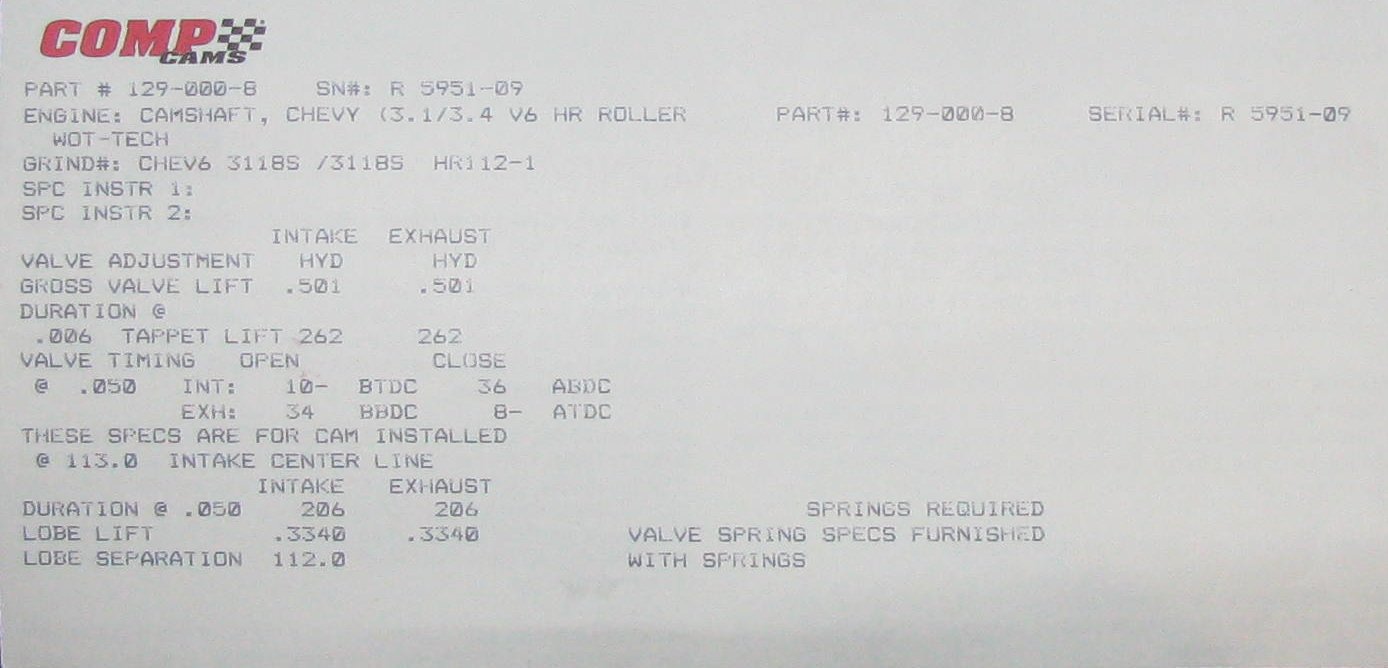

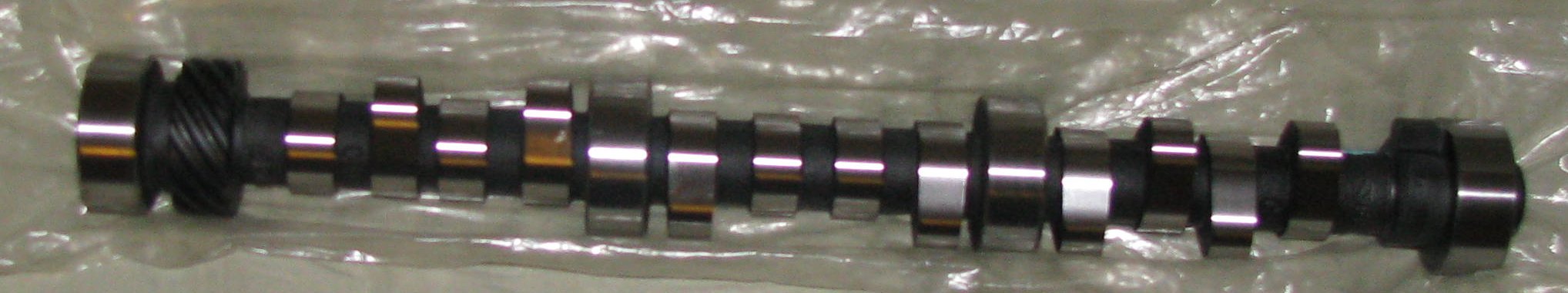

                      Got the cam/pushrods today. I attached the included spec sheet. it says it needs
                      different springs, so just want to make sure the 26986 Valve Springs are what I need.
                      Hopefully next week I can swing the headers and the tuner the following and get this
                      thing done already.

                        That cam spec sheet is allowing for a 1.5 ratio rocker arm, thus the gross lift of .501
                        Our engines using the stock rockers are 1.6 so the cam specs out at .534 gross lift.
                        So you will need the 28986 springs.
