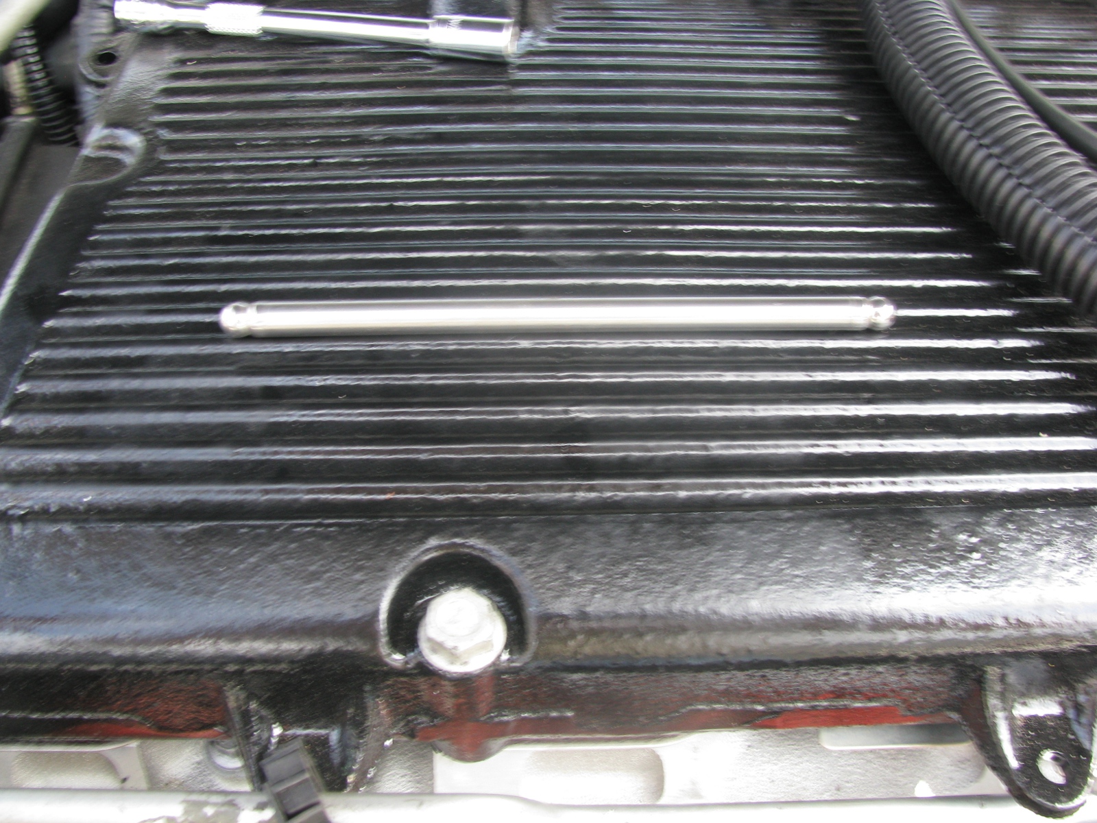

                            All the exhaust valves hit the pistons while the intake didn't. We triple check that the pushrods were installed exhaust being the longer and
                            intake shorter.
                            The pushrods don't look bent at all. The spark plugs were perfect. Just stuck valves on all the exhaust. The intake didn't hit and
                            looked fine.

                              Sounds like it only slipped a small amount compared to what usually happens. Most likely since the RPMs were low. I am sure that Ben can hook you up with some valves. Be sure to check the pushrods by rolling them on a very flat surface like a piece of glass. I would replace any with even the slightest bow.
                              Getting the broken pin out can be difficult. Usually when the pin shears it makes the hole egg shaped and doesn't support the pin properly. You run a high risk of a repeat if you don't repair the hole. Luckily, the journal with the hole for the pin is soft and can be drilled and reamed. You can open the hole up to a larger size and use a stepped pin or the cam and gear can be opened up to use a larger straight pin. We had a customer who used two pins 180 degrees apart.
