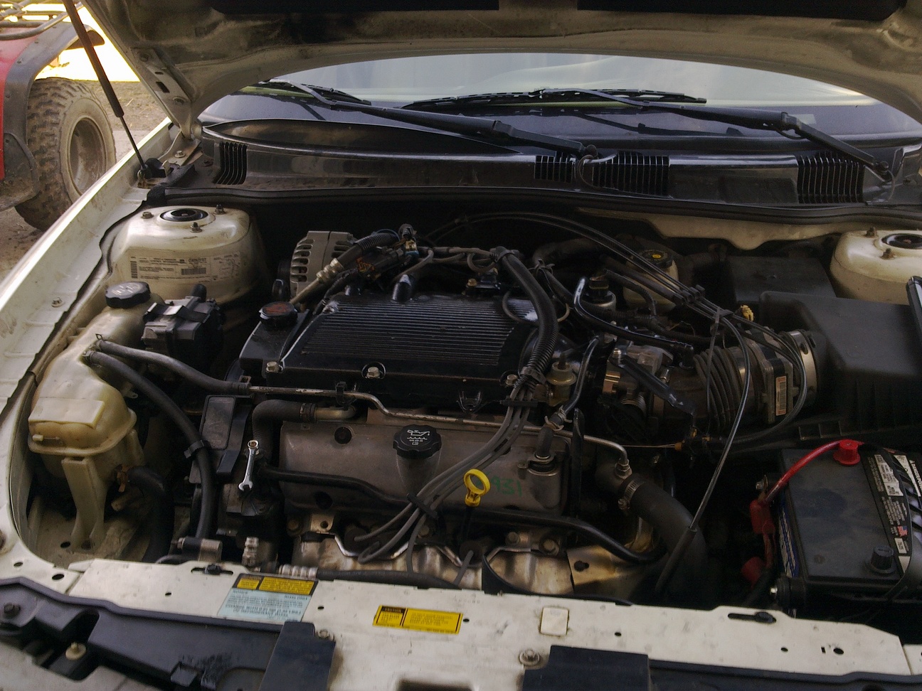

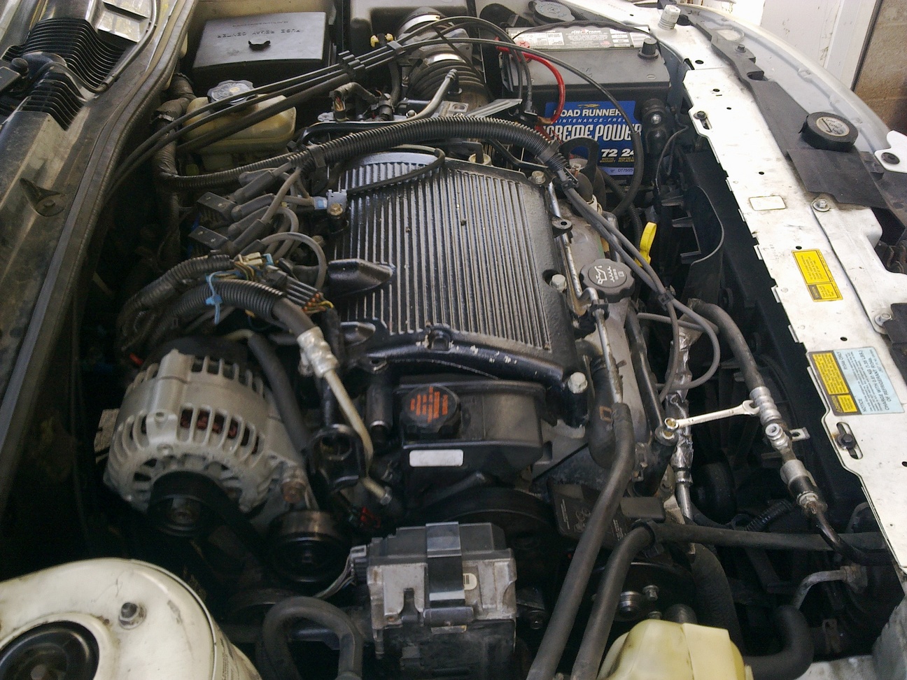

It's alive again but it's doing several really weird things.
1. The transmission won't shift into 4th anymore (2800RPM @ 55MPH) - was around 1900RPM @ 60MPH.
2. If I accelerate even moderately hard it'll rev up and down. I've taken a couple videos (I'll upload to youtube shortly.) I have to accelerate hard sometimes to get the gear to engage (IE, shifting from park to reverse.)
3. If I accelerate hard, it'll jump like it's between gripping (like traction control is on but it isn't.) Also it's on
dry pavement and I didn't WOT it. So there is no reason it would be breaking traction.
4. The overflow on the res tank is constantly spewing fluid. It causes an annoying squeak when pressure is applied to the accelerator.
5. The fans don't turn on. I'm going to test the volts on this from the connectors. It's such a odd thing because
they do seem to turn on every once and awhile but it's too irregular to drive in the city.
1-3 are transmission related I'm sure. The motor runs fantastic. The transmission is a 4T45-E from a 05' Grand Am. I'm thinking it may need more fluid pressure? It also has those inserts (which I regret doing after learning it'll burn it out after 50k or less.) Is this normal? Or could they have been put in wrong? If so, should I bite it and put a new transmission in?
Also with the old motor, I had a shop briefly look at it and they think it may have been a valve guide seizing.
He briefly mentioned causes but I didn't really understand what he was saying.
EDIT: 1-3 are fine. What's happening is abuse mode is getting triggered. I assume it's because I put the overheat temp to 230 in the computer. Well, if it's warmed up and I run in somewhere ... it goes over that temp. Maybe??? I'll probably adjust that to 240 and see if it stops. I can resolve it by clearing the DTCs so I'm pretty sure that's what it is.
Also the Res tank isn't leaking anymore so I assume it was overfilled (but it wasn't since it was right on the cold line.) Not sure how that works but, hey, not spewing anti-freeze is great.
