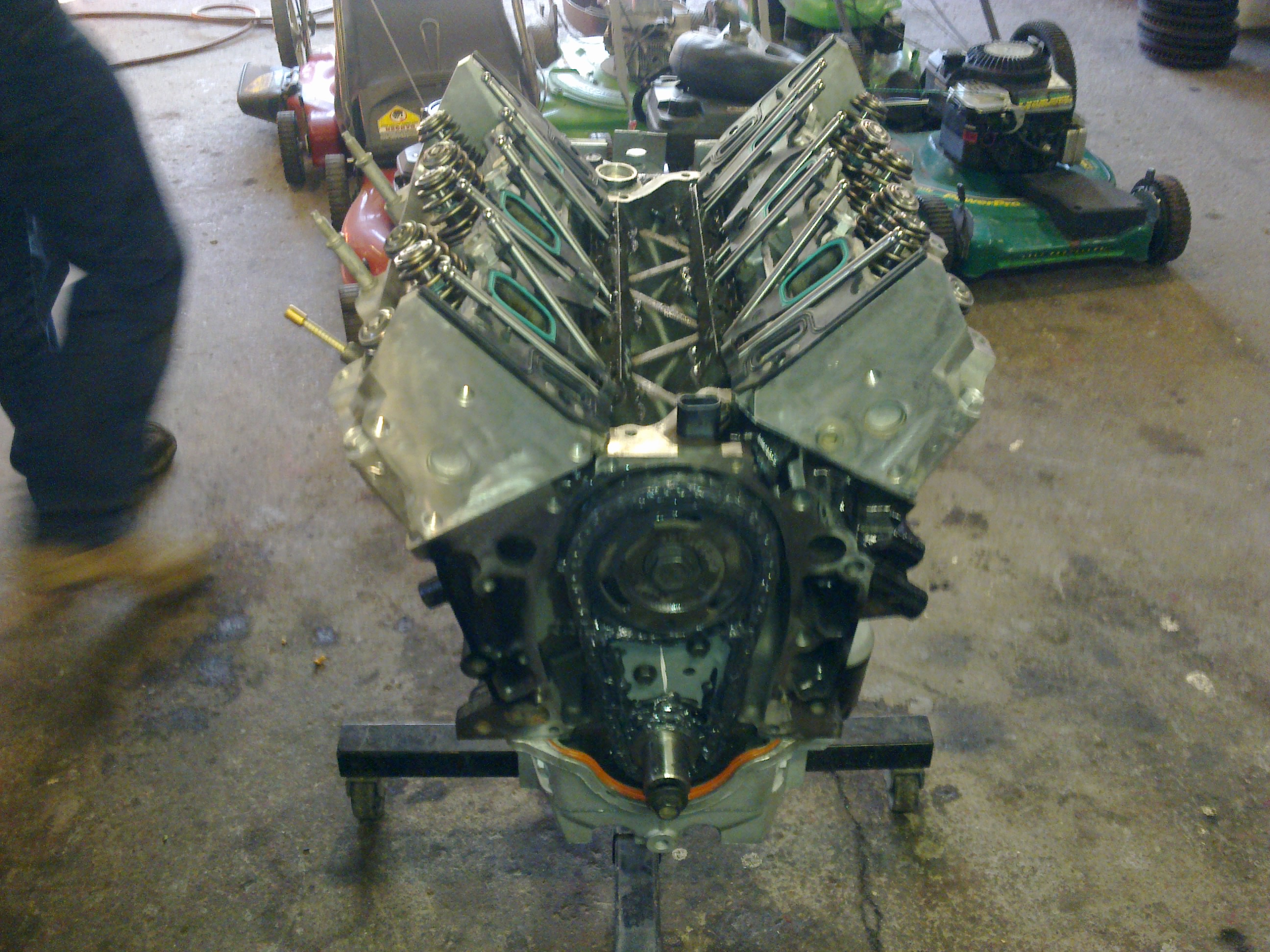

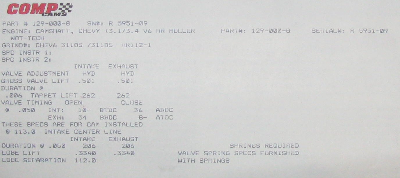

            Getting somewhere with the car. Got the timing cover removed and the timing was fine and the drive-pin wasn't sheered. I got some numbers for the pushrods but I'm pretty sure they were wrong. I suspect that his micrometer wasn't long enough and he tried to line it up to get the length. I went to the shop and pulled two from the new engine and two from my old 3400. I'm going to try to find micrometer Monday just to double check. It sure would've been nice if it was something as simple as a pushrod... But I don't think that's the case.
            I'm somewhat at a lose. One thing to note, in the last 4-5 weeks the exhaust valve springs have pulled the valves up some. I'm not sure if that's important or not. Looking for some idea. Hopefully will get it tore down to the block with week so any measurements, pictures, ect I should take to try and find out why it failed. I really want to get this thing on the road, but I'm skeptic about dropping change to get it redone until I know what failed and why.
            As far as I can tell, a Magical engine gremlin decided he'd bend the exhaust valves so I was stranded on a highway in 90F humid whether so he could lol at me whilst I sat and baked. Any suggestions would be welcomed.
            Comp Cams 26986 Valve Springs
            Fel pro head gasket
            GM stock intake gaskets
            Attached is the comp cam ticket
            Any other info, let me know.

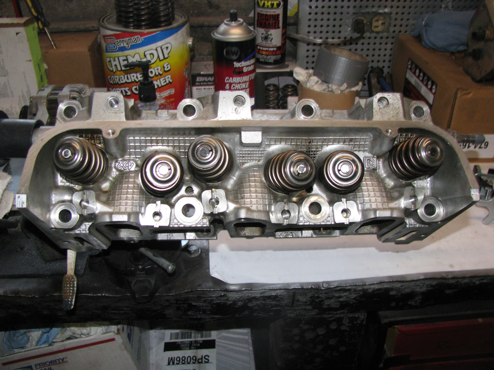

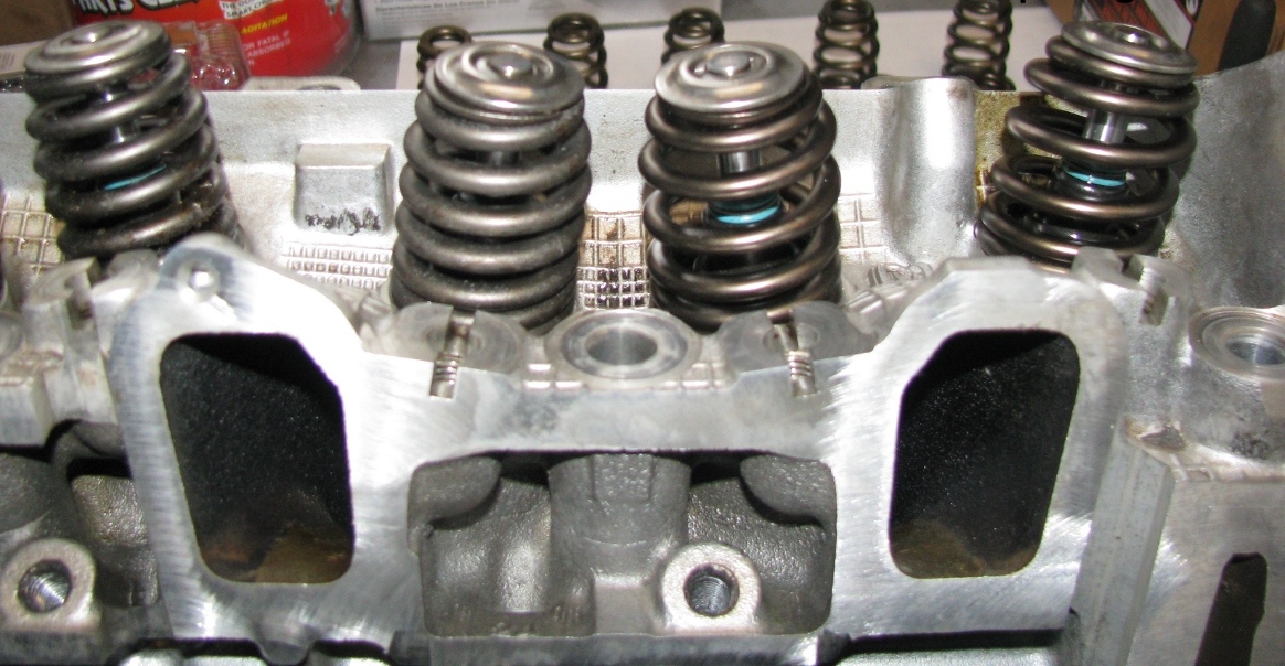

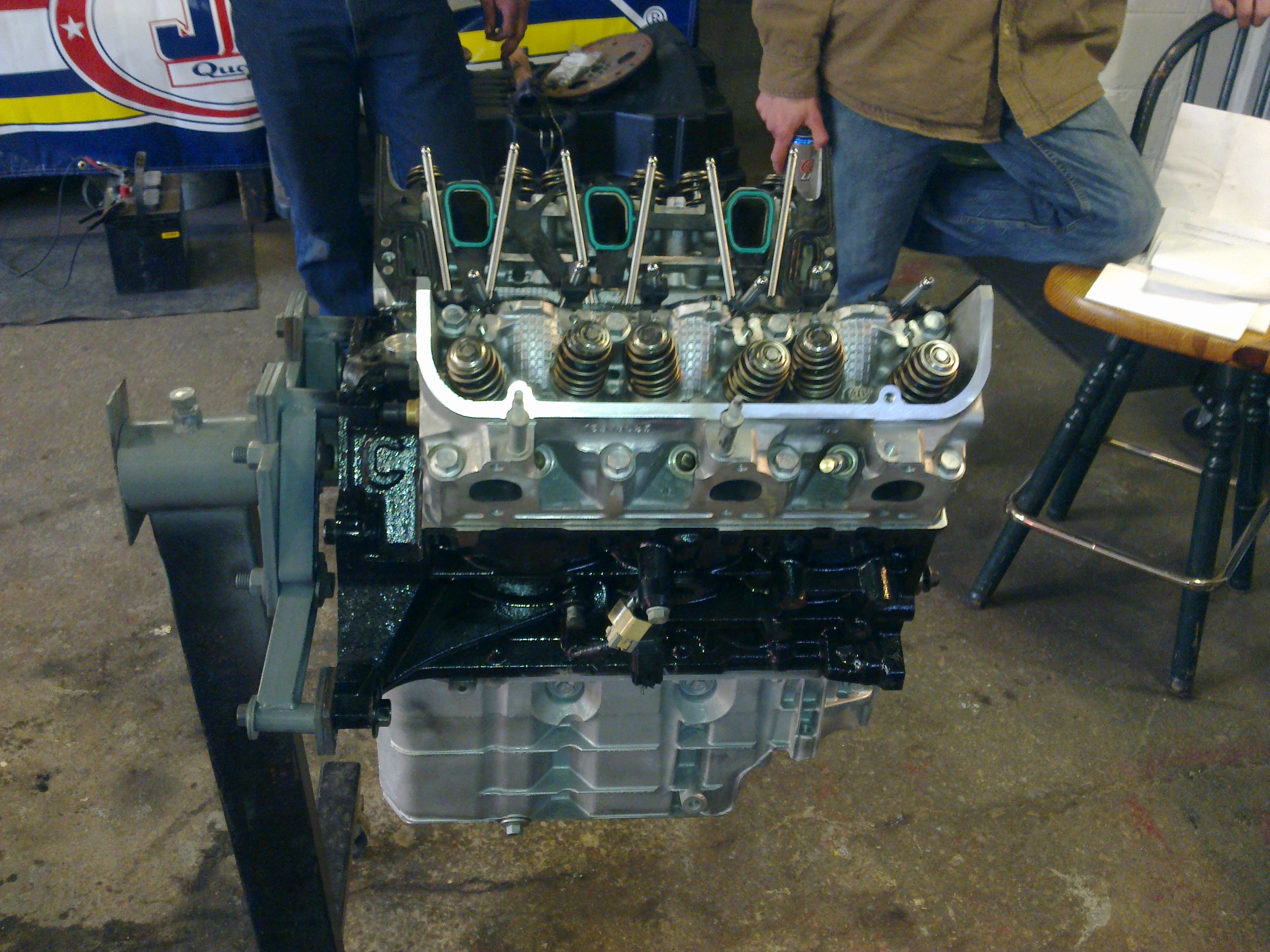

                I keep getting told it's a geometry issue or coil bind. Are the Comp Cams 26986 Valve Springs the right springs? I got the longer pushrods, as suggested. I used the stock seals, seats, lifters, rockers, ect. It's such mind----.

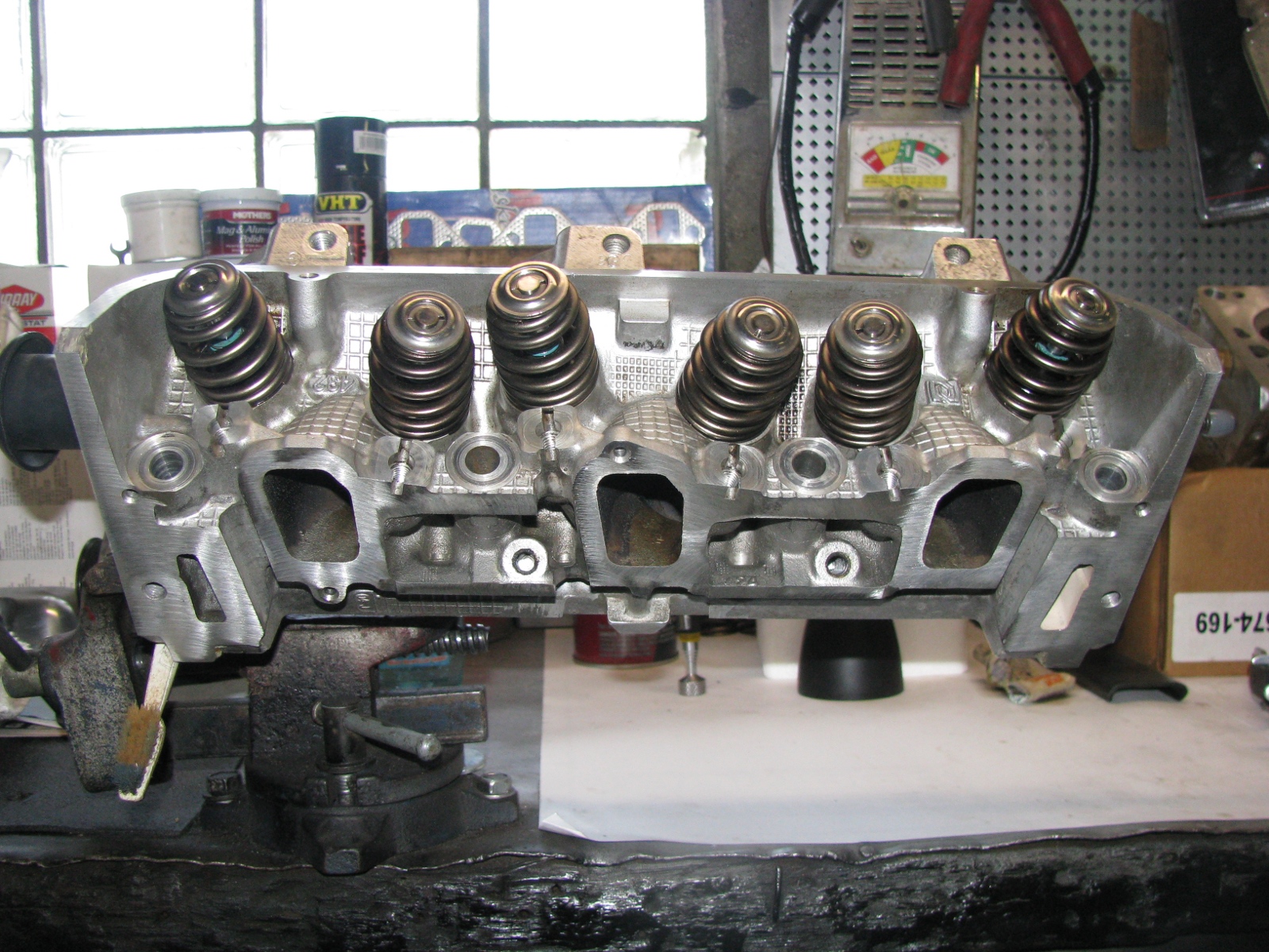

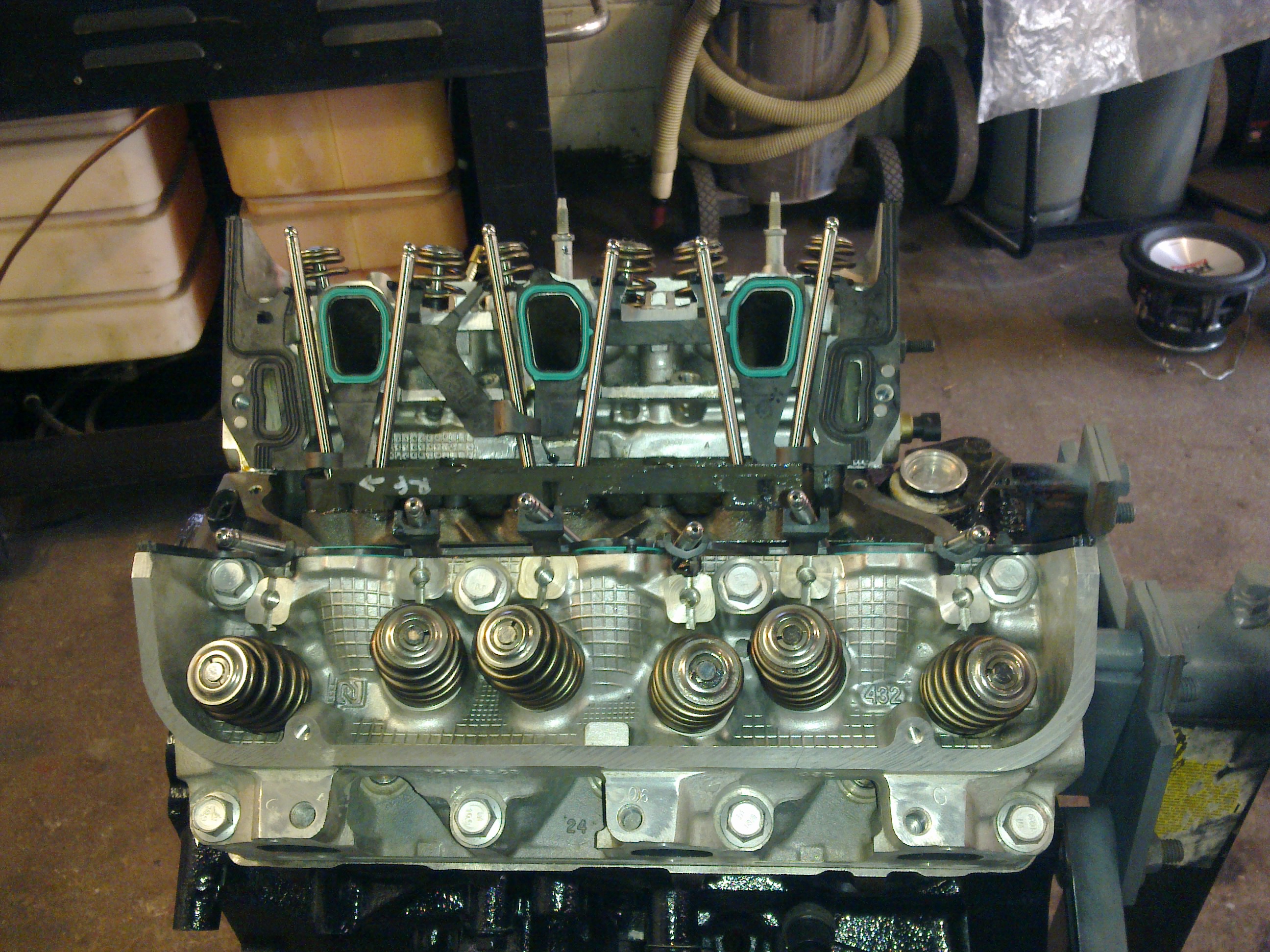

                    Pics of the pushrods during install. Count out coil bind then.
                    See attached.
                      • 13514
                      #85

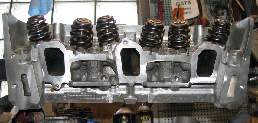

                      Make sure the valve stem is above the retainer and the rocker arm doesn't hit the retainer at any point. I had a problem with Comp retainers/keepers but never stock or Manley.

                        I'm not a valvetrain expert. How would I check to see if this happened? Pull a valvecover... What would I look for after that.
                          • 13514
                          #87
                          You want it to be more like the one on the right than the one on the left.

                            Hopefully I'll have my truck running good Friday/Saturday (depending if any deposits clear my account) and I'll try to run up there and get some better pictures. Here is a couple I have of the heads that are clearer than the one previously posted. I didn't notice the glare on it... Thanks for the picture reference.
