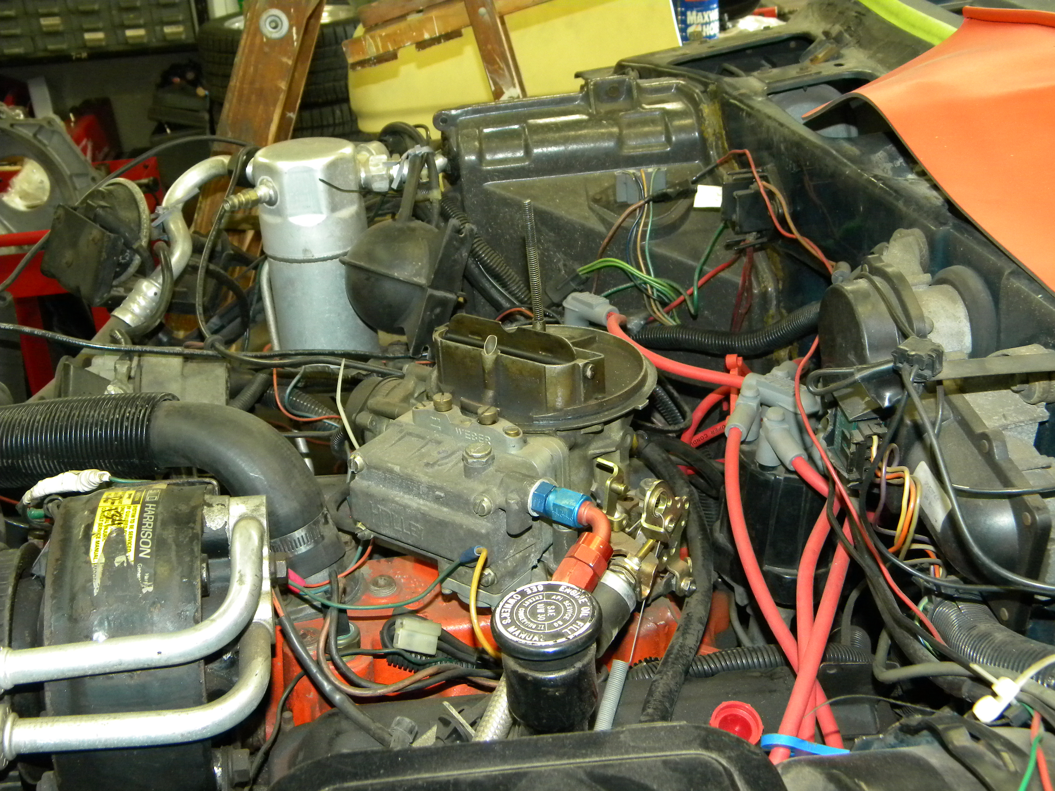

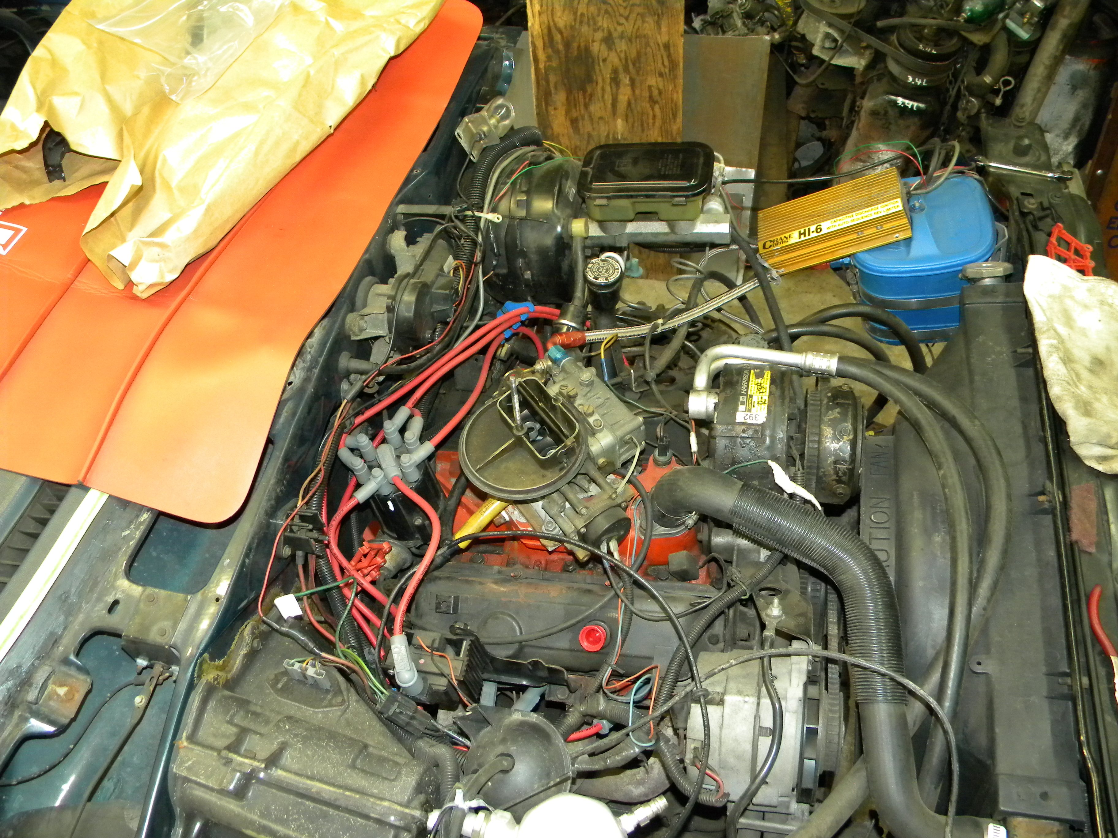

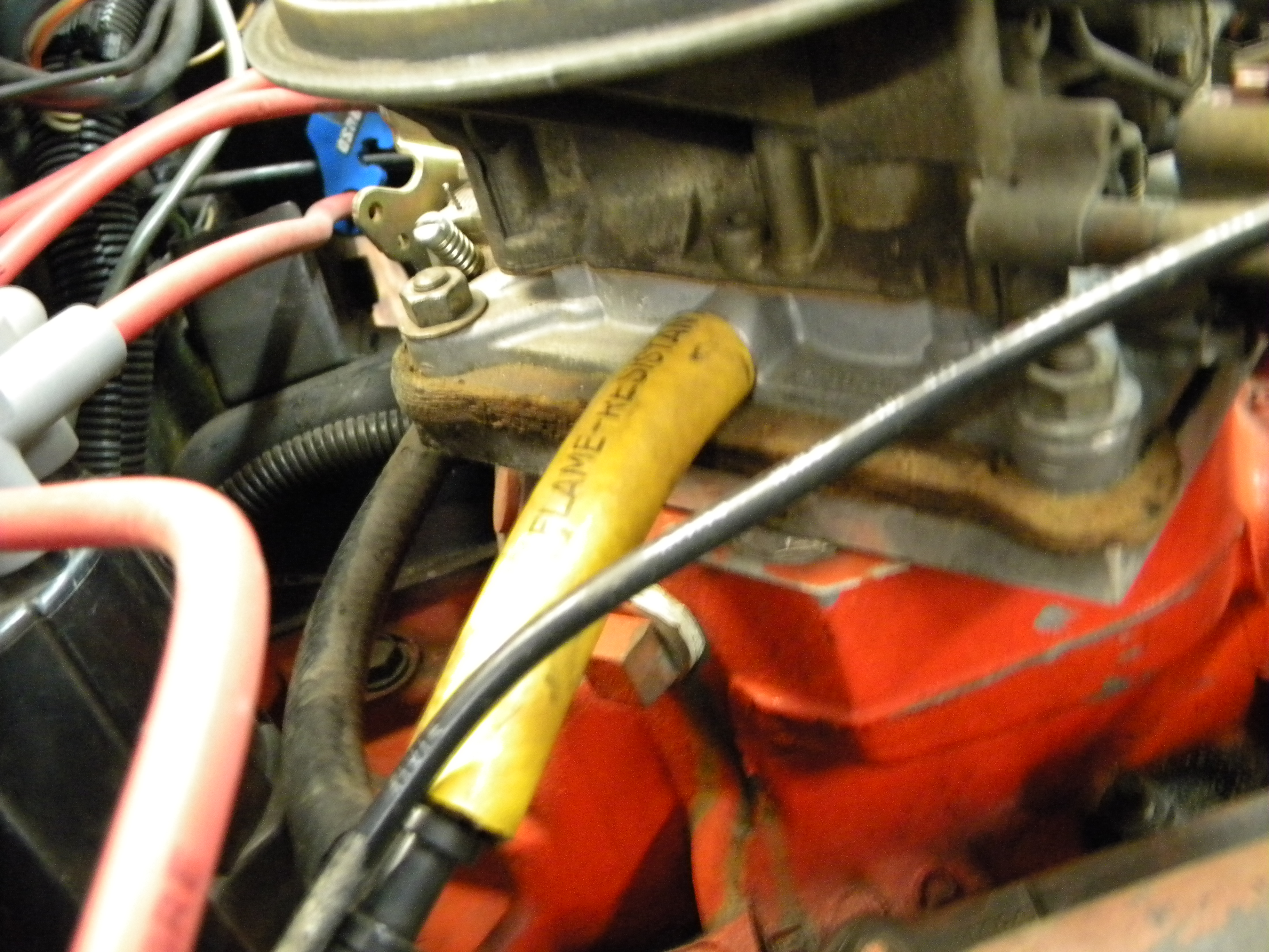

            I run an NA iron head 2.8L. I adapted a holley 500 cfm 2 barrel to a TBI manifold (alot of work!). crane roller rockers & studs, big crower solid cam (248Int. @ .050), machined heads to fit smallblock chevy springs, retainers & seals, crane CD rev limiter ignition (set at 7500 rpm w/stock resized rods!) , 1.5" long tube headers w/ 2.5" collectors, 3" exhaust. This combination has run dozens of WOT side-step launches at 7500 rpm at a local hill climb event and over 80K merciless 4-season street miles to boot with no failures whatsoever. I have run Koo-Koo juice cocktail - VP C-12 race fuel with 20% nitro-propane, 15% propylene oxide and a locked out distributer set to 40 degrees. I just can't seem to kill the little beast!

                      Whoa! Can you send me more pics of that truck and engine??

                        #26
                        ...will do...

                            #28
                            Holley 500cfm 2 barrel on a modified TBI intake

                              #29
                              ...pics too big ?...
