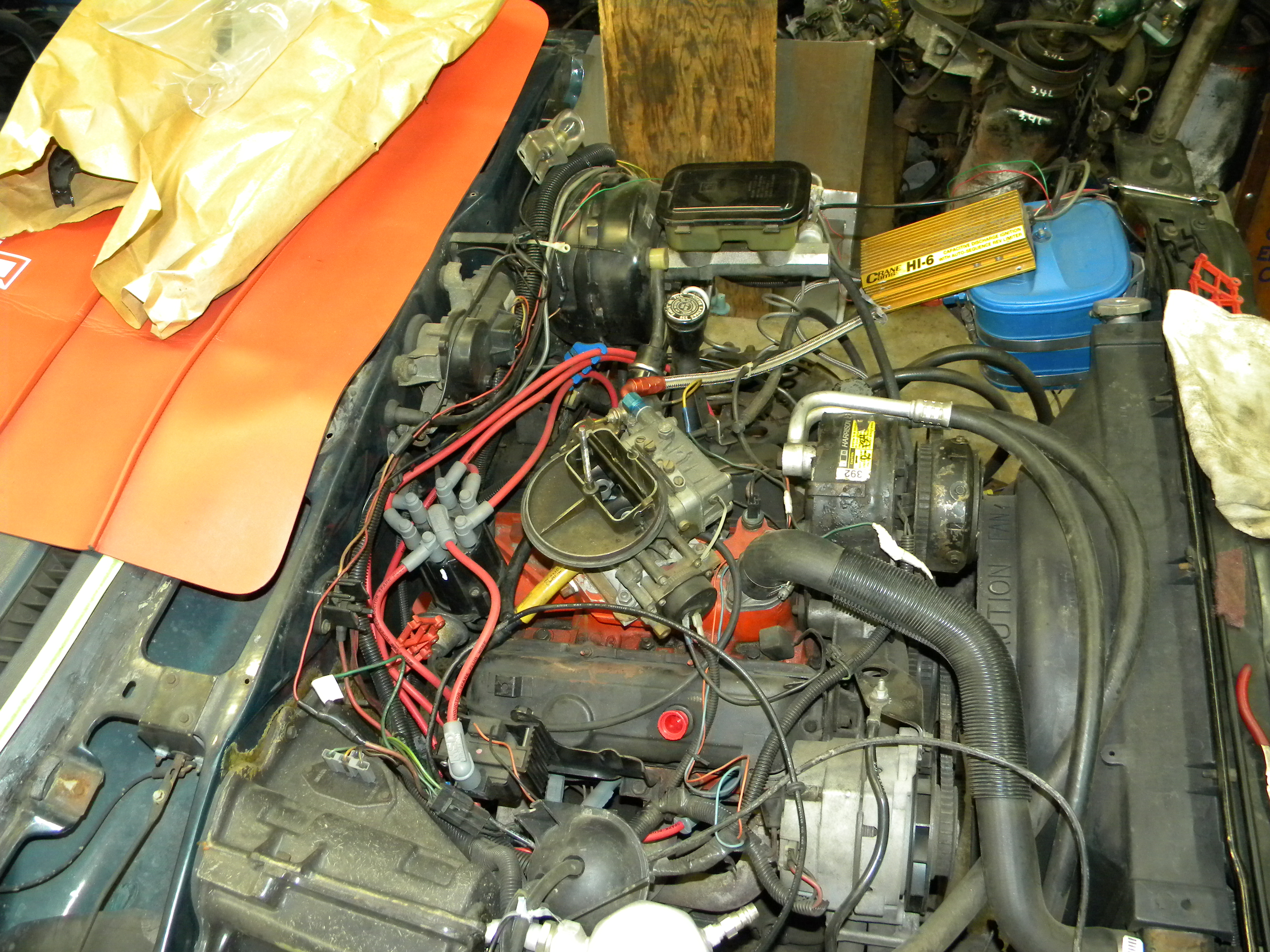

        Tuning a big cam with MPFI is not easy and the long runners won't make high RPM power. The Edelbrock manifold sucks for high RPM power because 3 of the ports are half sized to boost torque (it can be welded and ported full size- a lot of work). A holley 500 cfm 2 barrel can be mounted on a modified carb manifold or a modified TBI manifold-no easy way out here either. 11:1 + compression with iron heads is not possible without custom dome-tops (GM used to offer forged 12:1 2.8L pistons but no more) The Chevrolet High Performance Bible says an iron head V6/60 is capable of 1.5HP per cubic inch - 173 x 1.5=259.5HP! I think you will need to figure out what RPM range the truck will see on the race course and cam and manifold accordingly. My combo (stock shortblock, holley 500 cfm on a TBI, huge cam) really wakes up at 3500rpm and pulls hard through 7200rpm.

          ...the Edelbrock will only fit iron heads...I tried running a stock Edelbroc with a 390cfm #8007 holley 4 barrel and a 600cfm #1850 holley 4 barrel. It ran just OK. My modified TBI manifold with the holley 2 barrel was more drivable on the street and made way more power on the track. I could not fit a 4 barrel on a TBI manifold. I don't know if a welded and ported Edelbroc will make more power? I am in a similar predicament as you. I want to use the 3100/3400/3500 series heads with a custom pro-stock style tunnel ram triple 2 barrel carb intake and distributerless ignition (for carb clearance) on a 3.4L S-10 replacement shortblock. Other than spending big $$$ on a custom Hogan or Wilson manifold I don't see any aftermarket pieces available. I am trying to use a GenII lower manifold as a base for a fabricated tunnel ram. Maybe the CNC guy could make just the side pieces and bottom for experimental applications?
