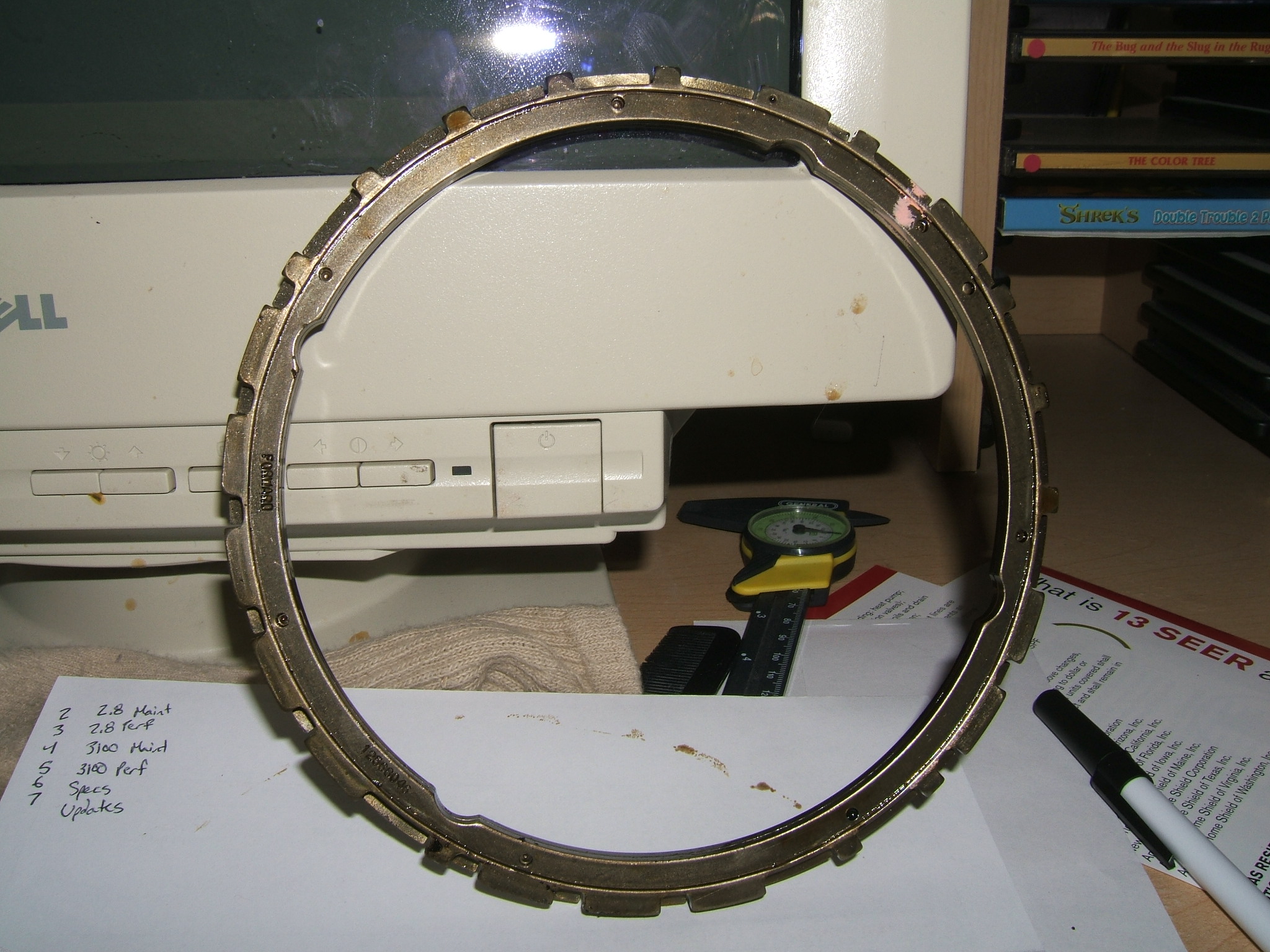

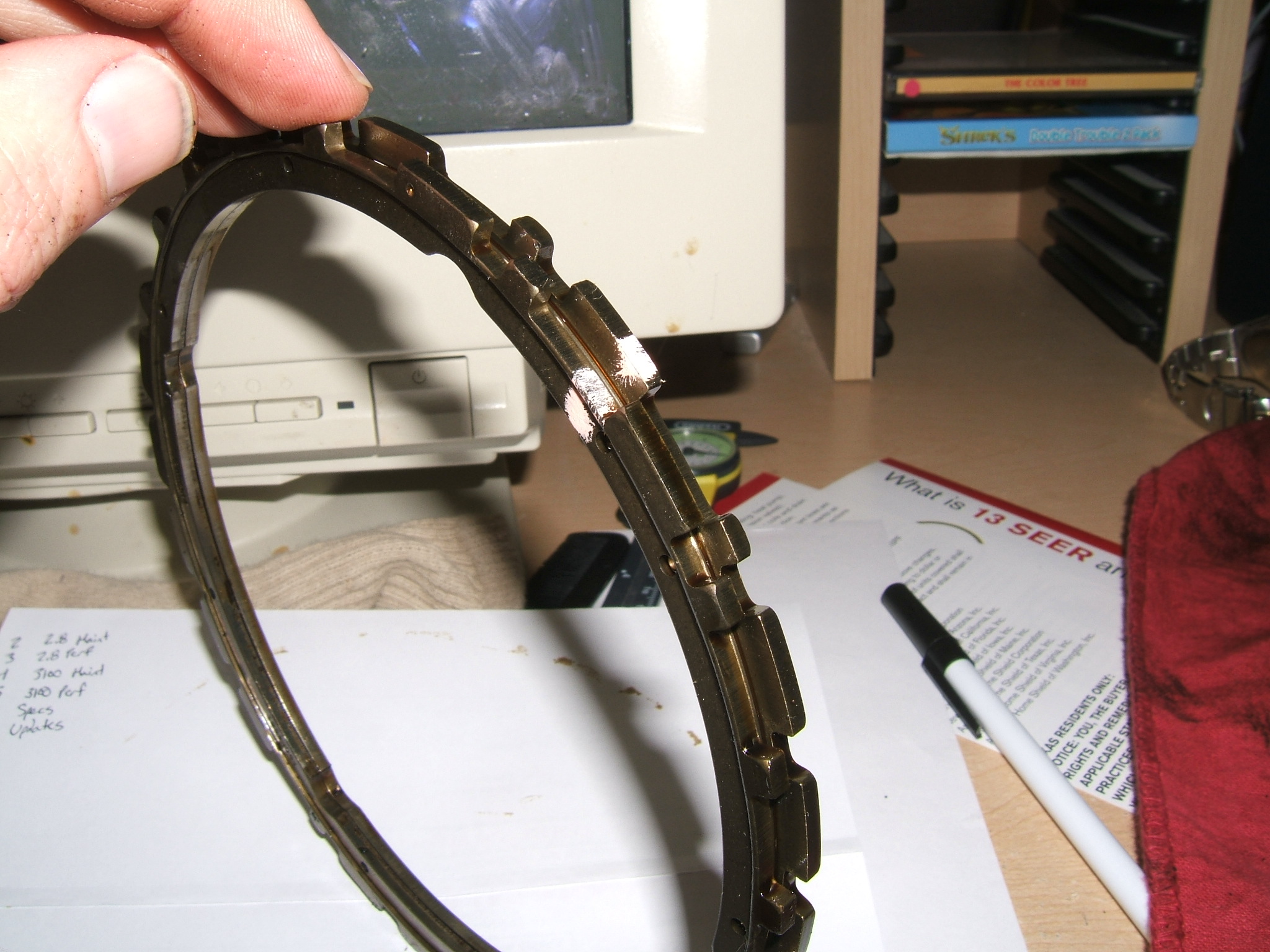

    Does anybody have a diagram of the lx9 trigger wheel? I have to figure out how to make megasquirt read the signal it's putting off. Does it have a notch every 6 degrees except for 2 to mark tdc or something like that?
    Trying to find a picture of it, but you won't be able to use it with MS. It is a coded trigger, so each cylinder is a different pattern. Ok, here it is...

    Here is a good thread discussing the trigger: http://60degreev6.com/forum/showthre...+crank+trigger
    The ignition control module from a 3400 requires a 7x signal doesn't it?
    Yes
