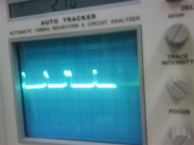

    I should probably start another thread but FYI, a 3500 CPS will read the 7x wheel just fine. It even puts out a clean square wave.. (Cell phone pic)
      Nah, it's ok. I wasn't sure about that so I used the CPS off of the 3.1
