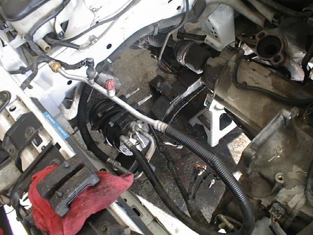

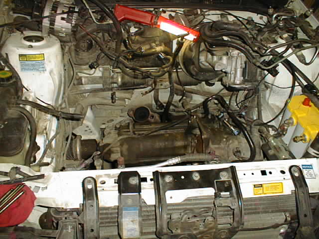

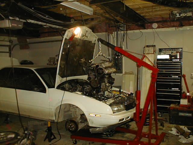

        Besides any trans mounts that bolt to the engine, I have never loosened or taken off any trans mounts when pulling the engine. L-bodies should be similar to N-bodies as far as engine bays go. I know it gets really tight on the passenger side trying to get it past the fenderwell, it you can do it.
        First time a pulled the engine (cam swap into original 3100)
        Next time I pulled the engine (3400 swap)

          you can get that back 18MM with a few extensions from the passenger side fenderwell, the AC compressor should slide down out of the way, check that everything is undone, and clear about 3 or 4 times, i alsmost always forget something. except the last time i did it. and if it looks like it could accidentally break with removal, just remove it. as in the rear O2 sensor. pulling off the alternator will help to, and put a jackstand under the transmission to keep it level while you pull out the motor, otherwise it will lean over and take up that little bit of space on ther passenger side.
          The braket on the tranny to the motor on the passenger is best to remove completely, IDK if that was asked but its answered
            Live life 3.7mi at a time
            • 4555
            Yup, after taking off engine mounts, roll the engine forward and grab off the alt in a fwd motor pull.
