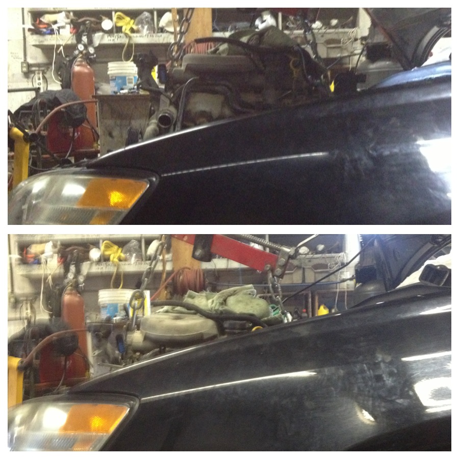

    some progress on my swap:
    comparison after moving the trans back an inch, as we can see a scoop will be needed.

    I thought about doing a similar swap about 2002 or so, but found that the engine would be through the rad, and didn't see much ability to move the trans back. I could have got that car cheap too...

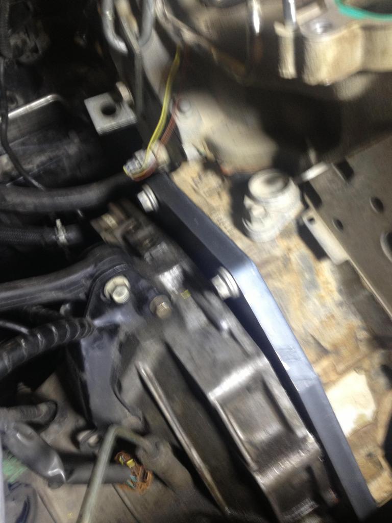

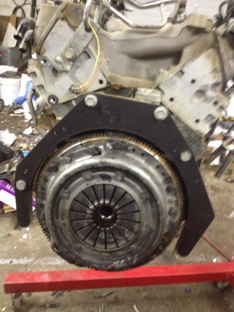

                      Small update. Had to notch the block to fit in the starter. Going with the 5.3 ls fwd starter so that I have room to make an engine mount where the stock starter would have been.
                      Also had to make the adapter plate 2 piece for this to work.

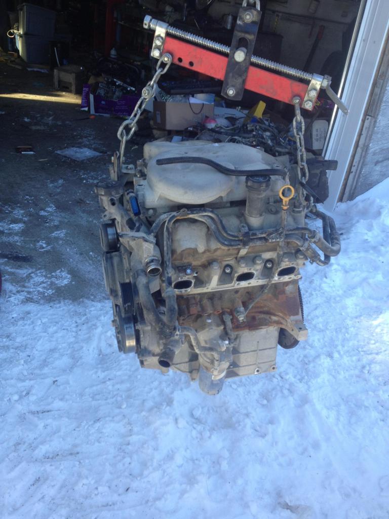

                        Small update.
                        Got engine in an playing with coolant hose routings. As we can see, the power steering pump is getting relocated to the passenger side to make room for the radiator return outlet and hose.
                        The outlet to the top rad connection and the rad cap will be placed in the center of the crossover tube. I will have an outlet to the heater core on the drivers side of the crossover tube, much like stock.
                        I noticed there is a post where someone talks of blocking off the second inlet to the wp( one that sucks from the crossover tube in the head, ) however if this were true then wouldn't the water pumps only source of input be from the Heater core return line? ( when thermostat closed). Once the thermostat opens it would suck also from the front radiatior. Would the wp have enough supply if limited to only sucking through the heater core return when thermostat is closed ? Bonus would be extremely good in cabin heat I would think. ( also wanting to run this through my turbocharger before going back to the heater core for even more heat in these cold Canadian winters.
                        ) can I block off this inlet or what bad could happen if I do ?
                        I was also thinking of running the big 3/4 inlet on the wp to the heater core rather than the 5/8 one, I think the stock Subaru lines might be 3/4 not sure on that one.
