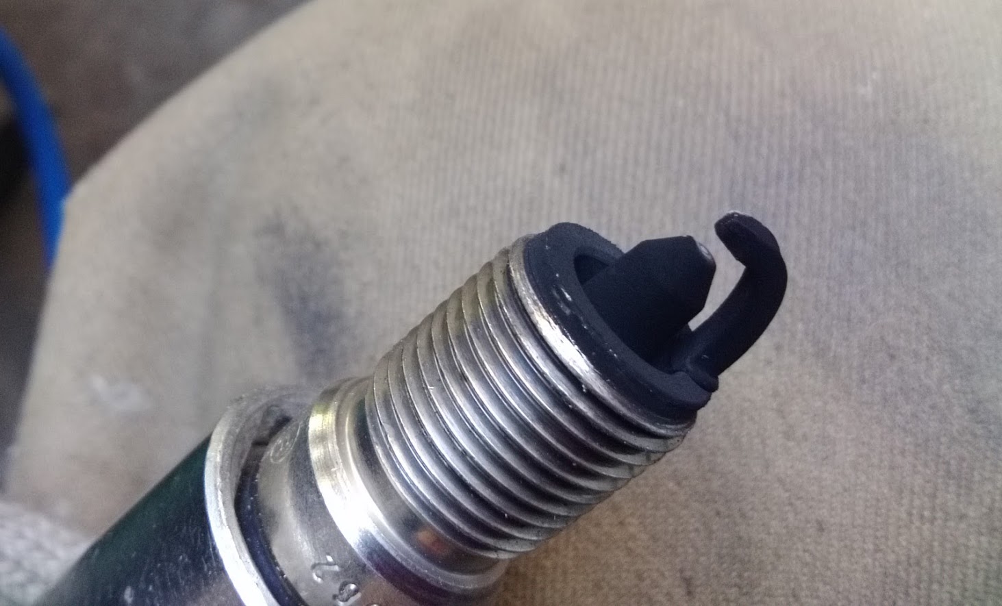

                            And here is the photo of the new sparg plug after several minutes of working

                              What happens if you open the throttle once it starts running? The adapter is installed on the stock chip, like this?
                              Chip on adapter across from the chip on the memcal
                              Running the stock 2.8 chip with 3400 Multec 1 injectors is going to be rich like the plugs show. How does it run with the WOT-Tech adapter/chip with the stock 3400 injectors and the 2000+ regulator? That might be worth testing.
