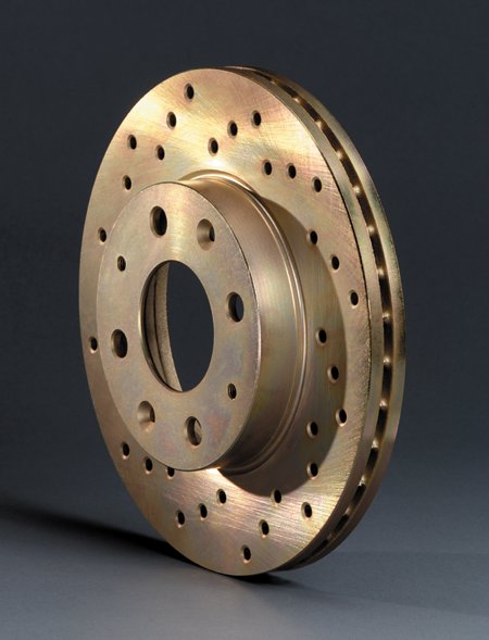

    BRAKES:
    FRONT ROTORS;
    Powerstop Cross-Drilled (Vented):
    10.5" #AR-8228
    11.25" #AR-8254
    REAR ROTORS;
    Powerstop Cross-Drilled (Solid):
    10.1" #AR-8251
    11" #AR-8229
