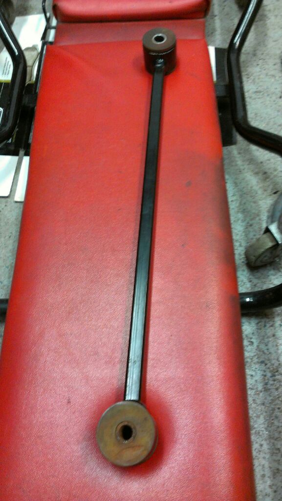

    I did, however, find some stock replacements made by Dorman that have 1/2" x 1/2" tube steel instead of the crappy U channel that stock uses. The Dormans do use rubber bushings though.
    I bought a set today (~$50 for the pair) and plan on removing the rubber ones and replacing them with the poly bushings in my stock ones when I start wrenching on the 92.

      The poly bushings for stock trailing arms DO INDEED fit the Dorman tailing arms.

        What poly bushings did you use in the Dorman trailing arms?
        I am debating if I should order the BMR trailing arms or if I should just get the Dorman.

          My stock arms had bushings from RSM. I haven't installed them yet so I could measure the bushings if you like.

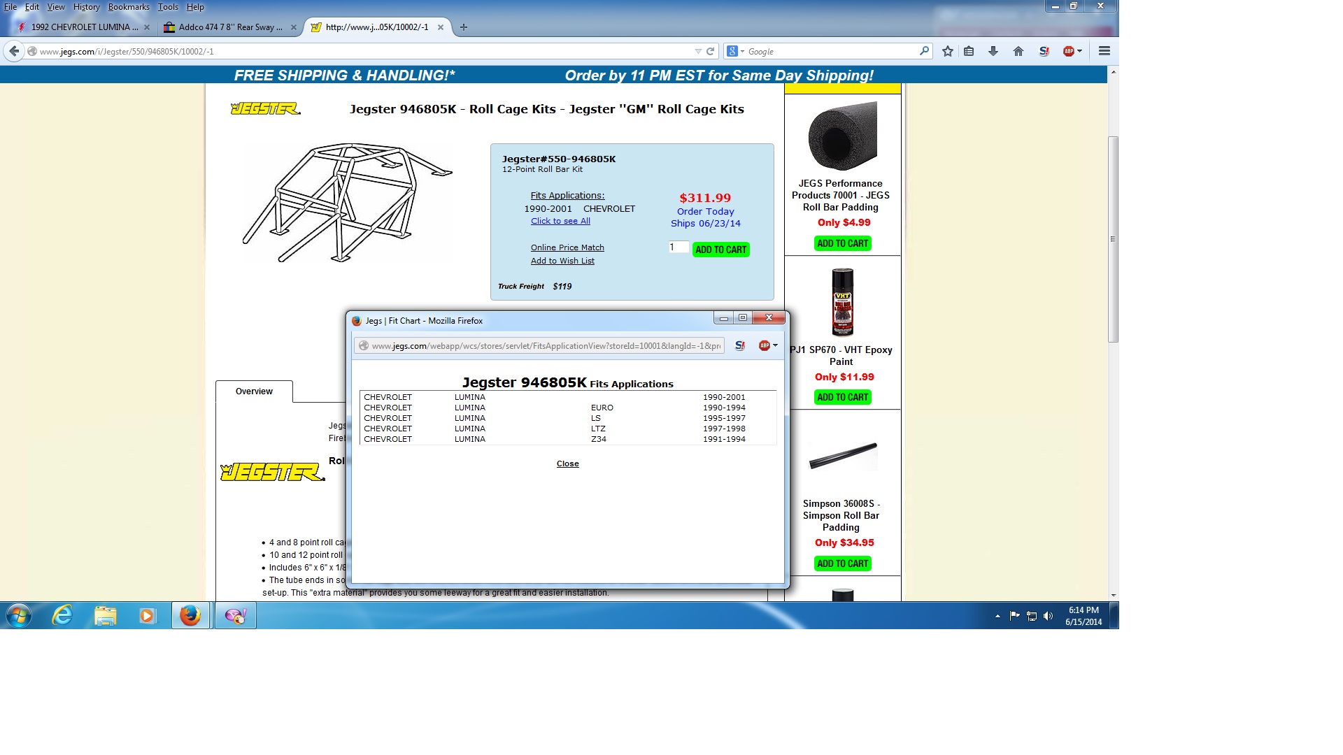

              This really isn't a suspension upgrade I found, more like a chassis upgrade. Very interesting, none the less...
Name:	lumina roll cage screenie.jpg
