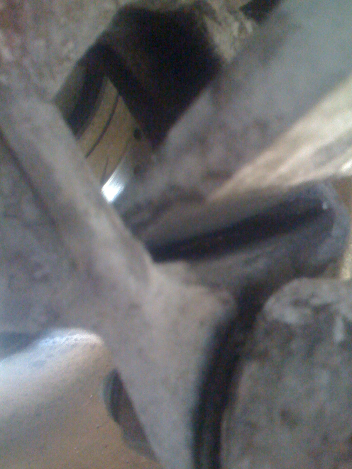

    As posted in the squeaking when hitting bump thread about my bad bushings on the rods that go from the support crossmember to the knuckle assembly i have this question/problem..
    Is This Bad?
    Robert

    Is that the end on the leaf spring?
      Yes it is..

        Looks like it has no rubber pad between the leaf and where it rests. If so, yes that is bad... sometimes they rot so much they just fall out. Not like your car is going to fall apart but that can definitely make noise. You need the NAPA solid replacement pads... there is a part number around here somewhere.
