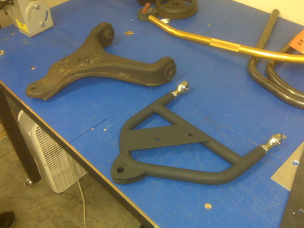

    my freind ordered a set of control arms for his 98 regal and i measured them and to my surprise the will fit my 93 gtp if anyone with my gen w body wants the link here you go ill be ordering a set for my car soon

    That doesn't look the same to me.

          Having just torn my front end apart, I'm curious as to how you measured those to fit. The balljoint and rear bushing look like they could be close, but there is nothing like that heim joint or the sway bar link in the first gen control arm.

                  The 1st GEN W-body control arm bushings Front & Rear are the same as ONLY THE REAR on the 2nd GEN W-body cars.
                  You would need Mark's Control Arm's...
                  Here is a picture so you can see a GEN 1 Control Arm and Mark's Tubular Control Arm's

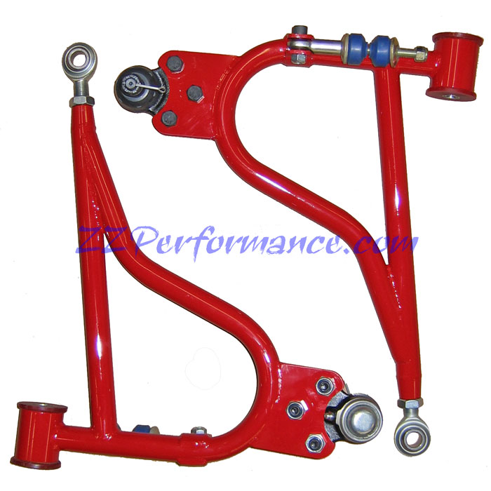

                    Here are the ZZP's 2nd GEN
