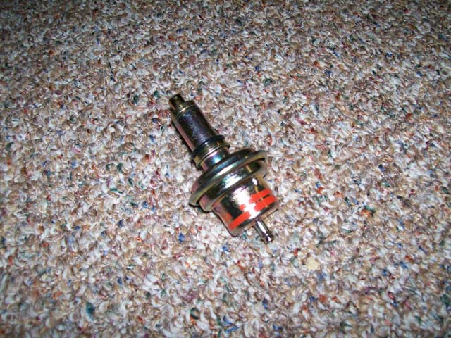

              Now... what the metal vac lines plugs into on the tranny, is that a modulator? Is this adjustable one supposed to be a replacement for that? Seems like it should be, but it's much smaller and doesn't have the vac port pointing in the same direction. Sure I could go find a T or something, but if it's a replacement I shouldn't have to?

                747017 Shows up as 83-91 4T60E on oriellyauto.com. Perhaps that's why the vacuum port is in a different spot?
                If you could do post pictures of the replacement. It is just unscrew and replace? I might want to do this to mine.

                    New adjustable vs the one in the transmission. Not only the vac port moved, but it seems a good bit smaller than the one in the tranny.
                    The new one did come with a piece of hose, angled at 90*, it may hookup with that hose I am not sure.
                    Anyone know why they used a metal line vs a regular rubber vac hose? Because of how close to the exhaust it gets?

                        Stock metal line is just for reliability, as you said the exhaust is there, and rubber can rot, and tear/etc. So they went with hard line. Plus it stays in place better. On mine it T's off at the modulator and goes to my vacuum tank with a check valve there. But looks just like yours, and says Holley on it.
                        The replacement I wouldn't worry about the size, just different brand/construction. It came with a 90* elbow to make it work with the stock routing it seems. Use that and you should be fine.

                                use the rubber 90* it will fit perfect.

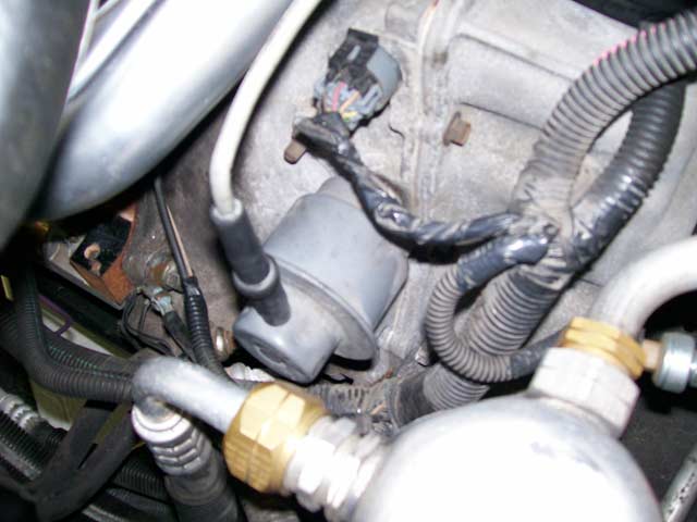

                                A pic of mine a long time ago.. Remember I have vac lines tapping off for the hvac controls, yours doesnt have all that crap.
