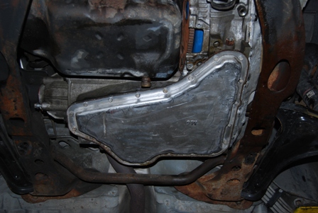

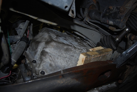

                              #44
                              here's a few pix!
                              Andy
                              fastest 1/8: 10.19@ 67.17
                              fastest 1/4: 16.16@ 82.70
                                • 9191
                                #45
                                Looking good! Had a chance to mess with the standalone controller yet?
