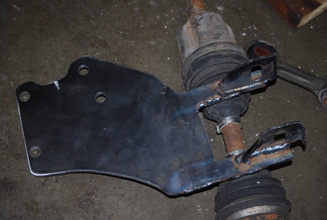

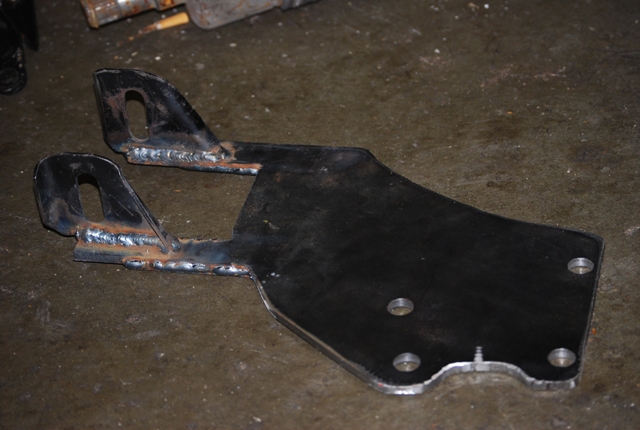

          we have a tranny mount bracket welded and bolted in currently hanging the tranny!! need to figure out a dogbone mount, pass axle (will attempt a 97 GA drivers axle), mount and splice the wiring harness, and mod the pass tranny to block bracket, get a shifter cable from a GA, retta, etc., and fab a shifter cable bracket. think thats all. should be done earily next week.

            'll get a couple of pix of the modded tranny mount tom. L-body is a good source for ideas and some parts. though, with the smaller engine bay in the Z, you are forced to cut and weld some.
            i do have a few more pix of the tranny and surrounding area if ya'll want to see more.

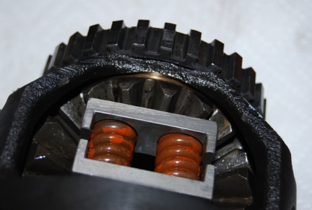

                  BLING!! One CHERRY LSD!!
