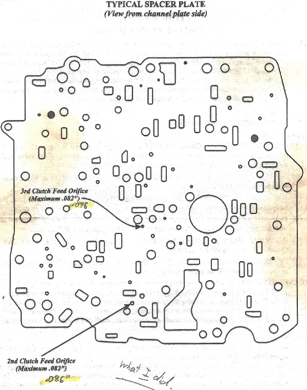

      When shimming the accumulators that much, does it make it bang when it shifts or does it just shift faster? The firmness is good stock, I just want it to shift quicker like on downshifts...
      The 4th hub makes a good cookie cutter!!
      I was looking for the same thing you are. Drilling the 2nd and 3rd clutch apply orifices larger made it shift faster without needing more line pressure. The shift kit and shimming will make it shift faster and firmer without more line pressure. More line pressure will create a faster and firmer shift too. Though, anytime you make a shift event faster, it will be firmer. The question, as always, is how much firmer? You can make things even faster by taking the excess play out of the clutch packs. Quicker yet not firmer. The motion from slipping to full engagement doesn't happen quicker. It just takes less time for the whole process since the extra play is out of the clutch packs.

        HEY torq! You shouldknow better then to post info without a diagram, pics, certification, in triplicate!, etc, etc, etc... :P
        So on that note:
        Could you get a pic of what holes your talking about drilling and what size drill bit? lol thanks bro

          Is drilling the 2 and 3 orifices part of the transGo kit?

            We did two i remember. i'll have to see which ones we did.

              drilling is not part of any kit. it's a standard procedure while rebuilding the 65E. for big HP/TQ, the holes are drilled a little bigger.
              95Sleeper...i could show you what i did, but i'm certain your separator plate is different than mine. i'll post a picture anyway. contact Dave at http://www.tripleedgeperformance.com/ he does some work the the 60E too.

                  that'd be cool! i finally got the pic up. damn, computers!!

                    I think I have a sheet at home but I'm probably wrong... the 4t60e also has something of that done when using the Trans Go shift correction kit, but I can't remember off the top of my head which holes are drilled... I know one Is plugged, one is oversized and one is made smaller. IIRC, and then there is a new passage that you need to make on the VB and one you need to plug.
