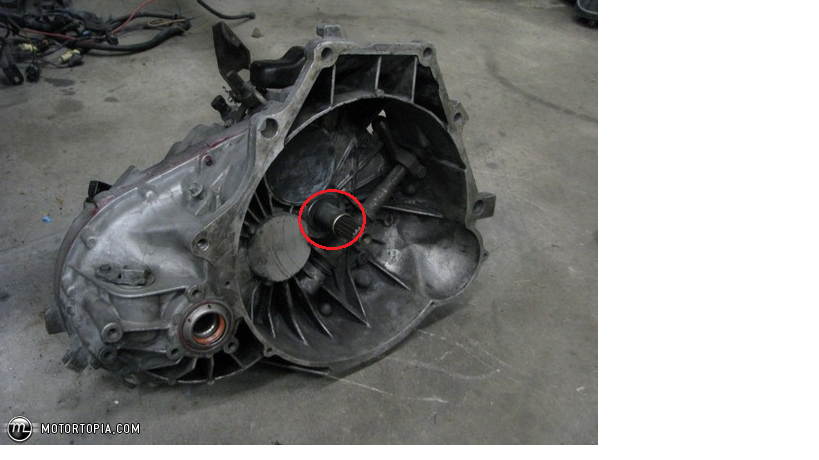

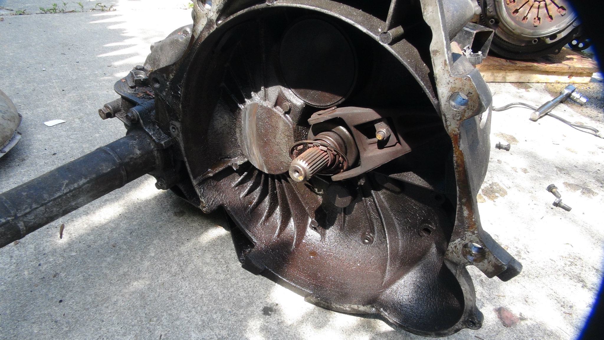

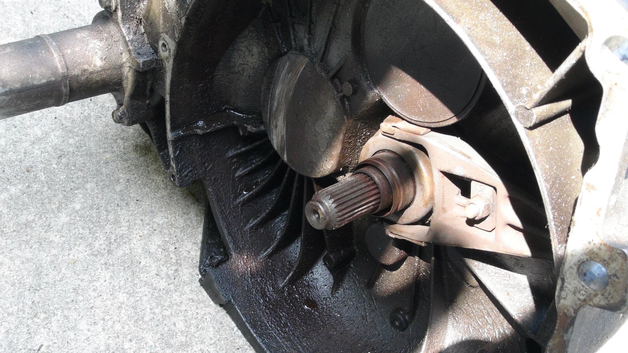

      Here are some pix of the trans when i first pulled it.

            That pic of your clutch fork is wrong. The fingers of the fork go in to the 2 holes on the side of the bearing.
            • XsMagical
              • Apr 2012
              • 15
              yea i know, thats how it was when i got it, the guy who sold me the car said he put the clutch in backwards lol. but the new clutch didnt want to stick
