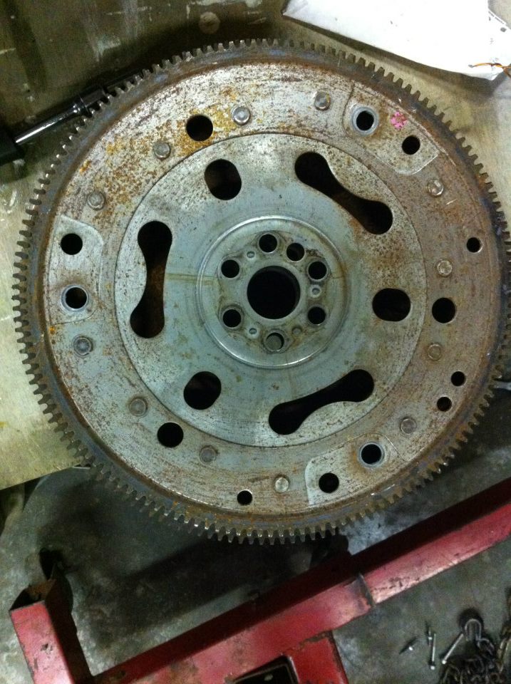

      And I picked up a flywheel from a 95 Firebird 3.4L. It looks like bolting to the auto flex plate will not work as I will need shims between the two, and the Firebird flywheel's ring gear will interfere with the starter. I think, however, that with a flywheel shim, the 3.4L flywheel will be thick enough to work with the LT1 T56. My T56 is almost out of the car and my trans adapter should be here next week.
      My question is, however, since the 3.4L flywheel has a slightly larger diameter, can I just shim the FWD starter the difference in radius between the flywheel and the flexplate to use it? They seem to have a very similar distance between teeth but the flywheel does have IIRC 6 more teeth than the flexplate.

      Flexplate shown over flywheel

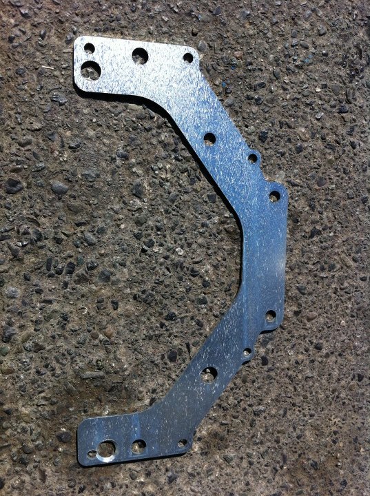

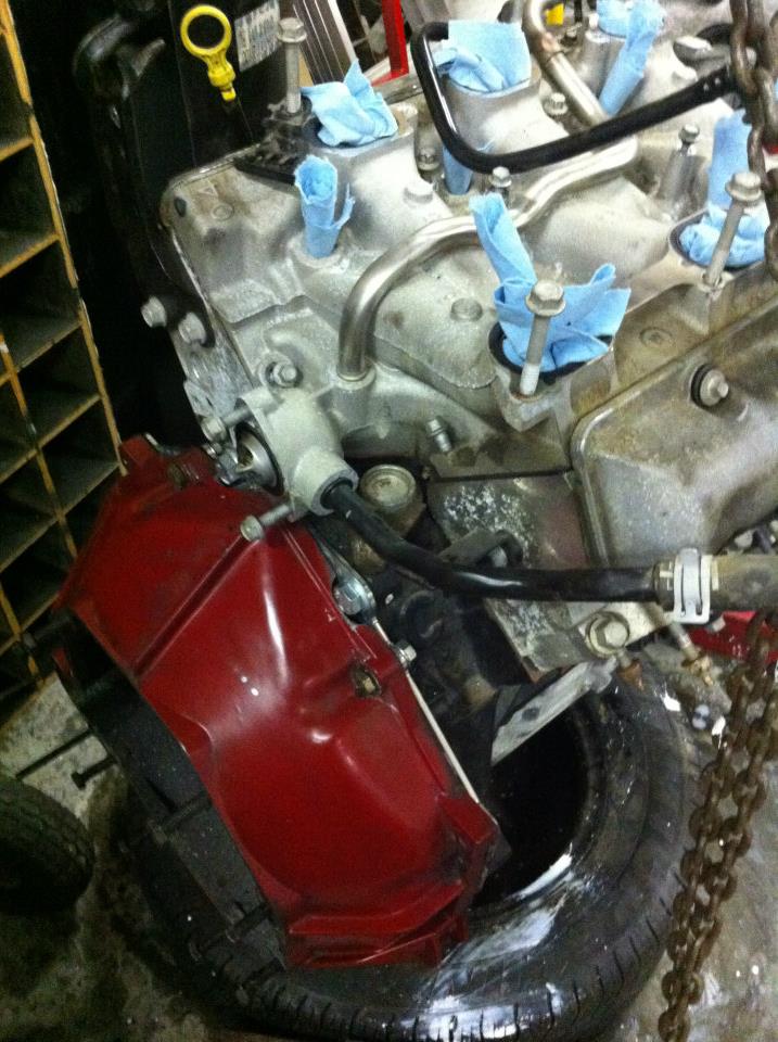

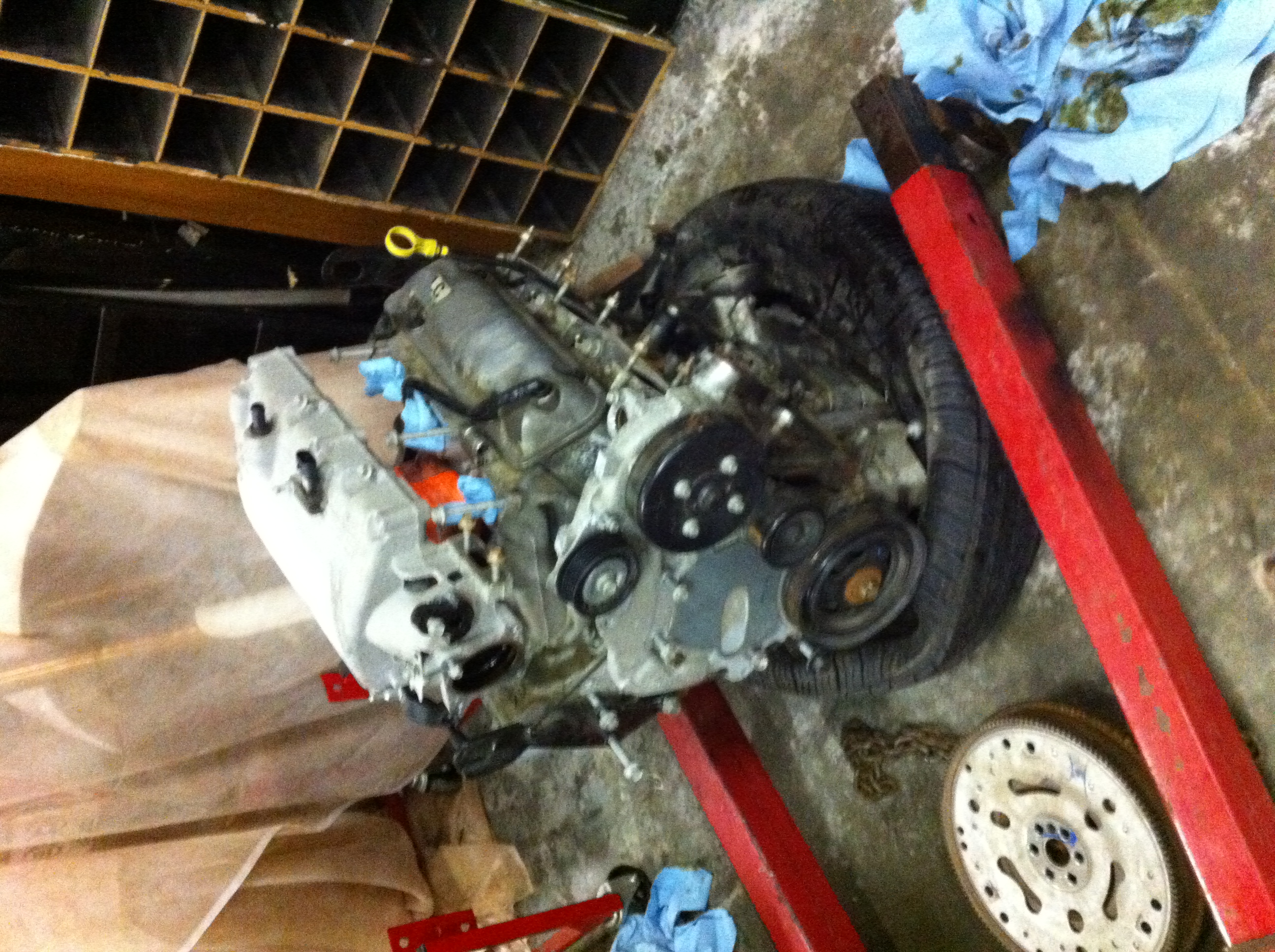

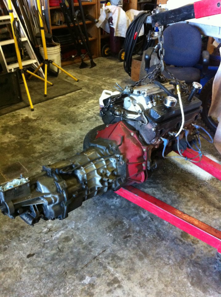

              Ok time for an update. Trans adapter arrived today so I pulled the old engine out of the Firebird with the T56 to start the test-fitting process.

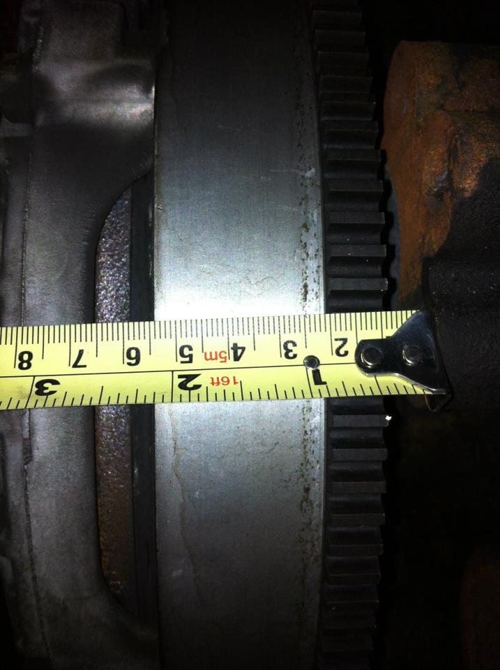

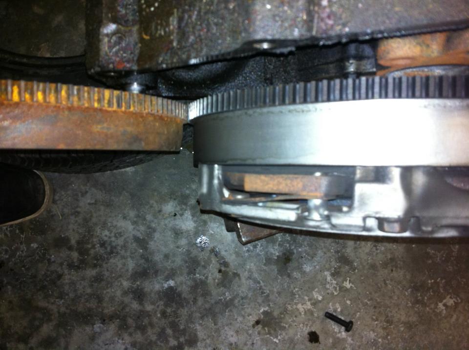

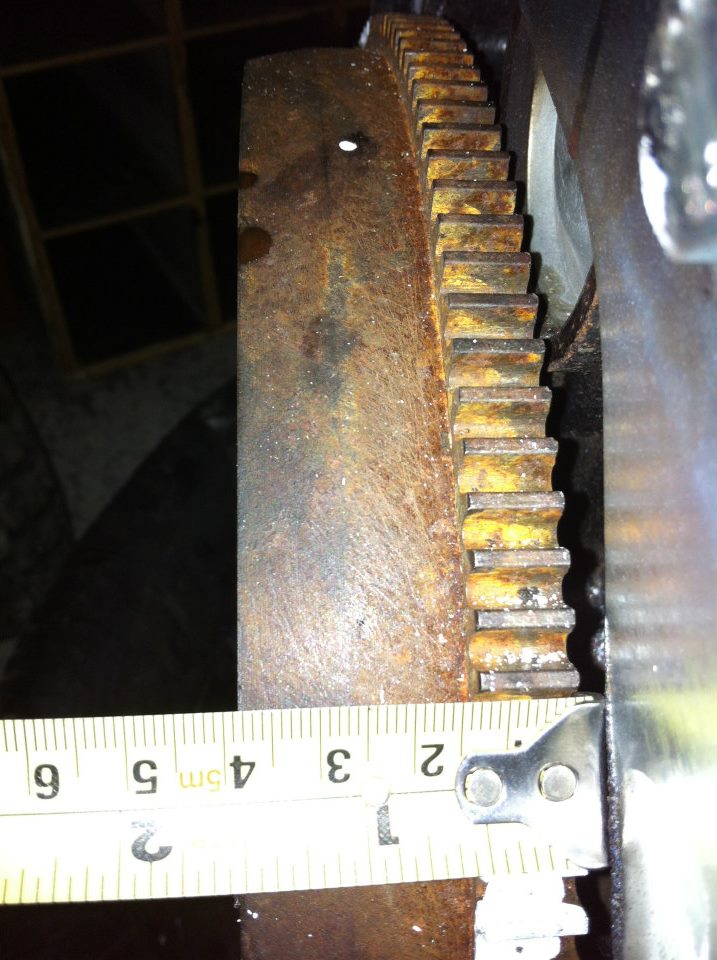

              It looks like the LT1 flywheel protrudes from the block face an extra 15mm compared to the 3.4L flywheel from the adapter face:
              If I could bolt the flywheel over a FWD flexplate it appears it would make up the majority of the difference:

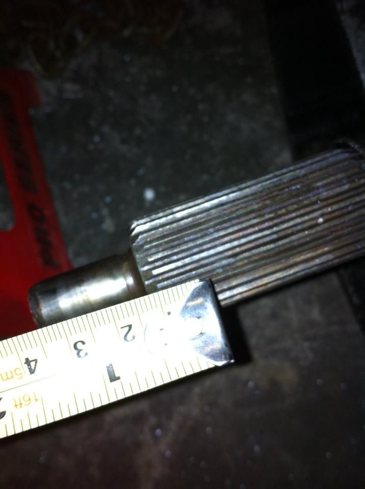

              And the worn area on the trans input shaft appears to be just over 11mm from the tip of the splines:
