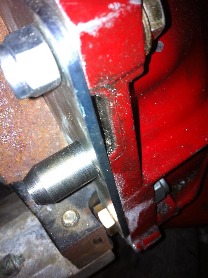

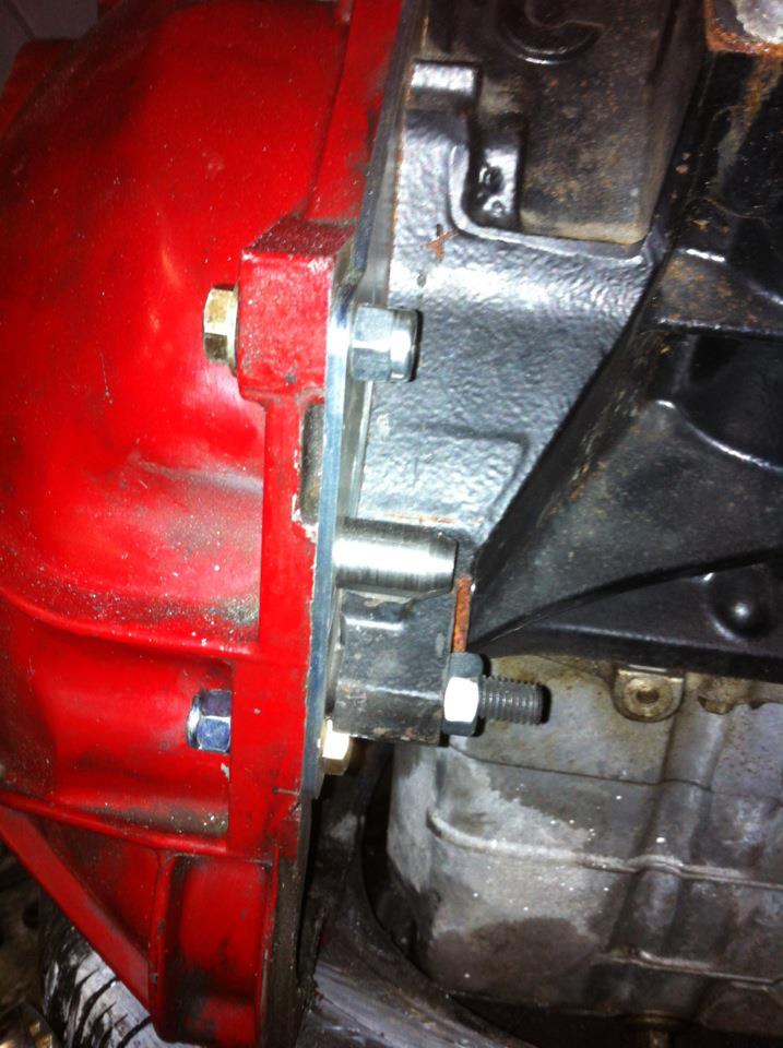

        Got the bellhousing fully mounted to the engine today:
        I found I had to grind the block a little where the countersink bolt is supposed to go on the adapter plate to get it to seat properly. Also ground a little slightly below for the bolt to go into the bellhousing
        And here on the other side I ground a bit off to seat the other bellhousing bolt.

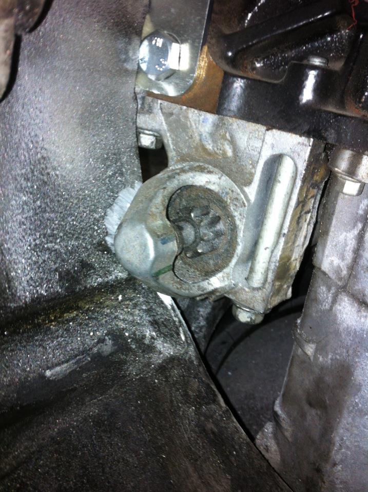

        Then I moved on to starter fitment:
        Some minor clearancing was neccessary to fit the starter and more will be needed once/if I shim it out for the RWD flywheel

          Nice, I see you got the shield around the starter to fit
          Do they meet or is there a gap between the two? Don't want that rattling against the bellhousing, might amplify enough to trip false KR. Easy fix though, silicon, rtv, gap....more grinding, lol.
            What is the goal again? Car type, power, etc....I forget. If you don't mind I ask.
            I just wanted to get an idea of fitment for now. It's most likely touching right now (I know that would be bad). If I end up using the starter ring on the rwd flywheel I'll have to grind more since the starter will need to be spaced out.
